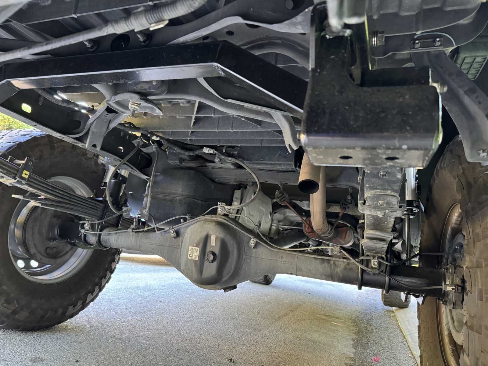

    Exquisite work done by Ryan…….just to “wet anyone’s whistle” who’s considering this!

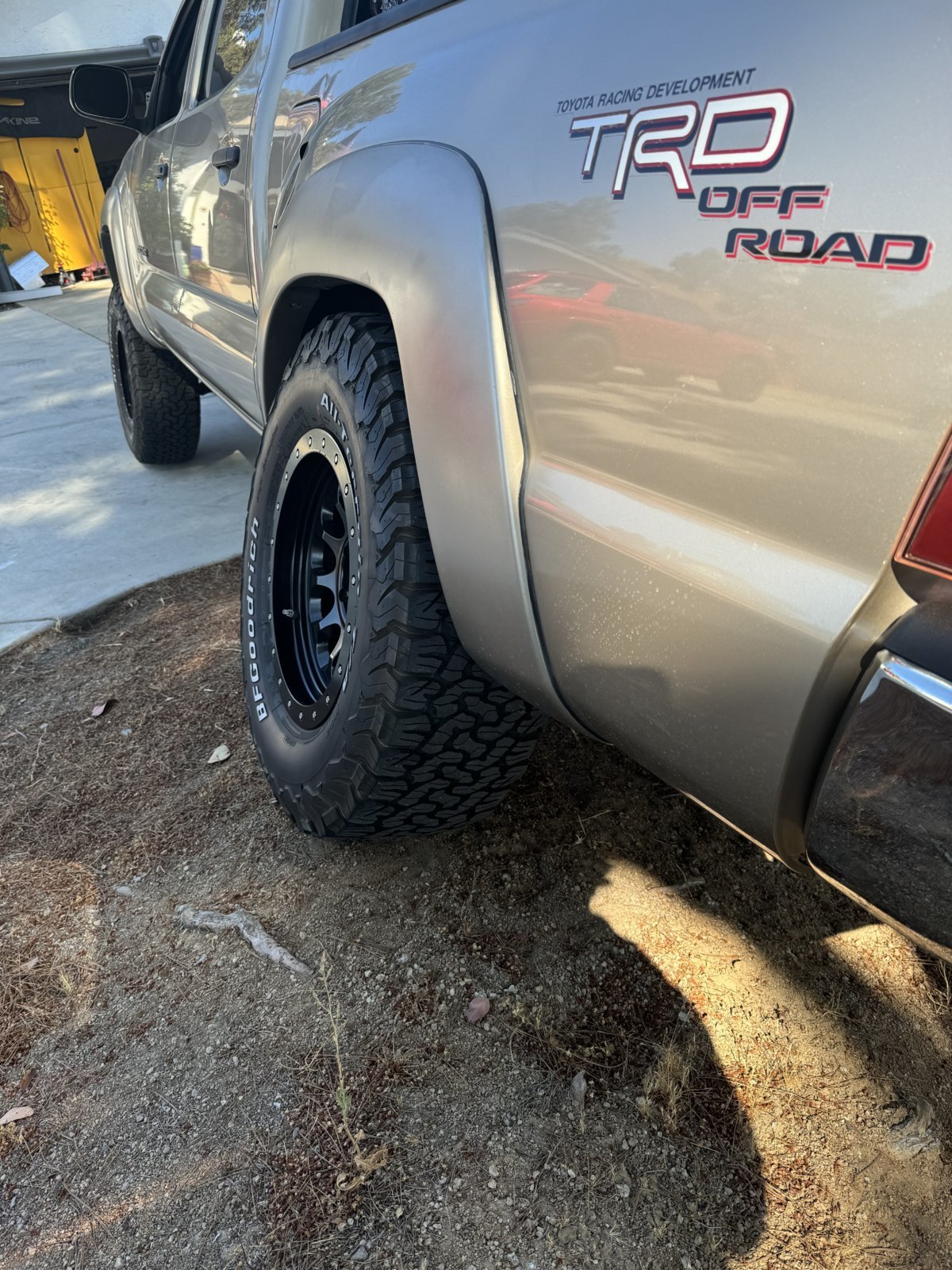

    If I'm understanding right, Archive suggests a maximum 3.5" backspacing (4.75" Wheel Backspace, 1.25" Spacer) for wheel/tire clearance with 2.5x12 smoothies. Not sure what tire size that's for, but I'm guessing it's 285/75R17 (34x11.25?) due to how common they are. I'm running 35x10.5R17 Kendas, 4Runner SEMA wheels (17x7 +4mm, so 4.16" backspacing), and 1.25" Spidertrax spacers, so:
    4.16" Wheel Backspace - 1.25" Spacer = 2.91" Backspacing
    I'm good to go, right? Or am I misunderstanding? Just want to make sure I order up a thicker spacer before I install next week, if need be.

    You're good with those specs!

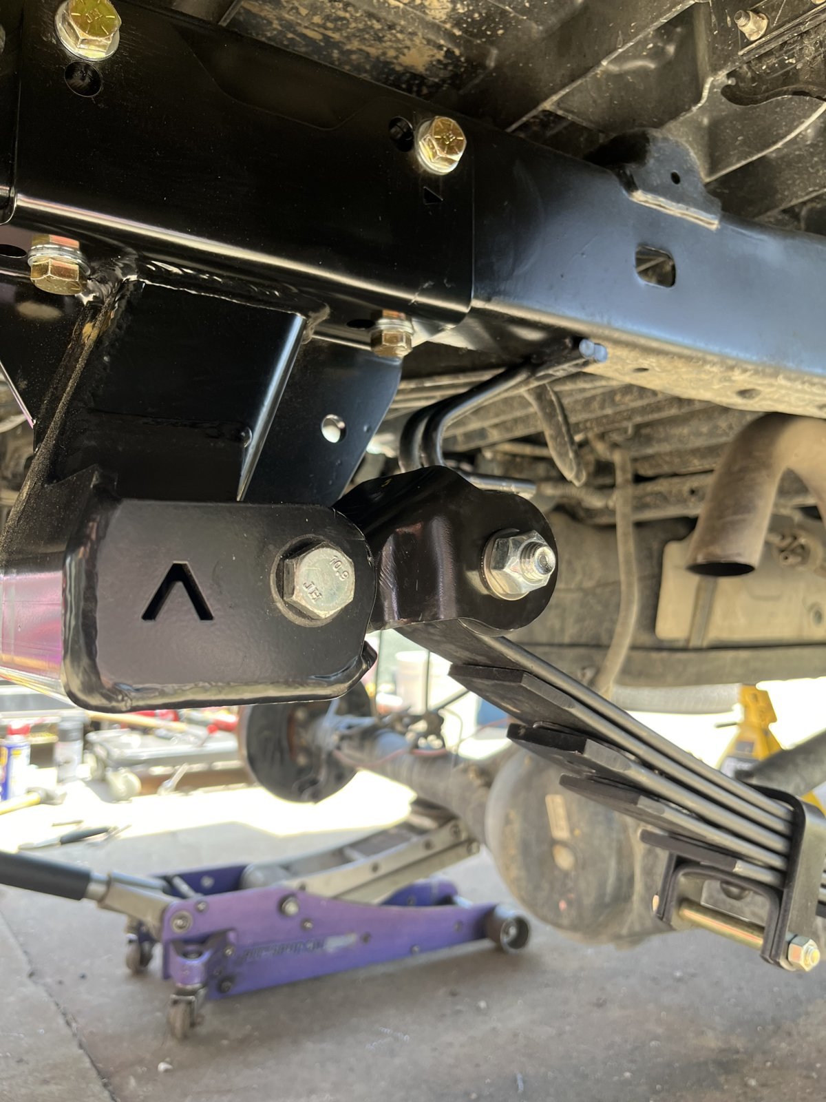

    Have had the truck back for a little over a month.
    Trail Series shock relocation w/ Fox 2.0
    HD Hanger, shackles & cross brace

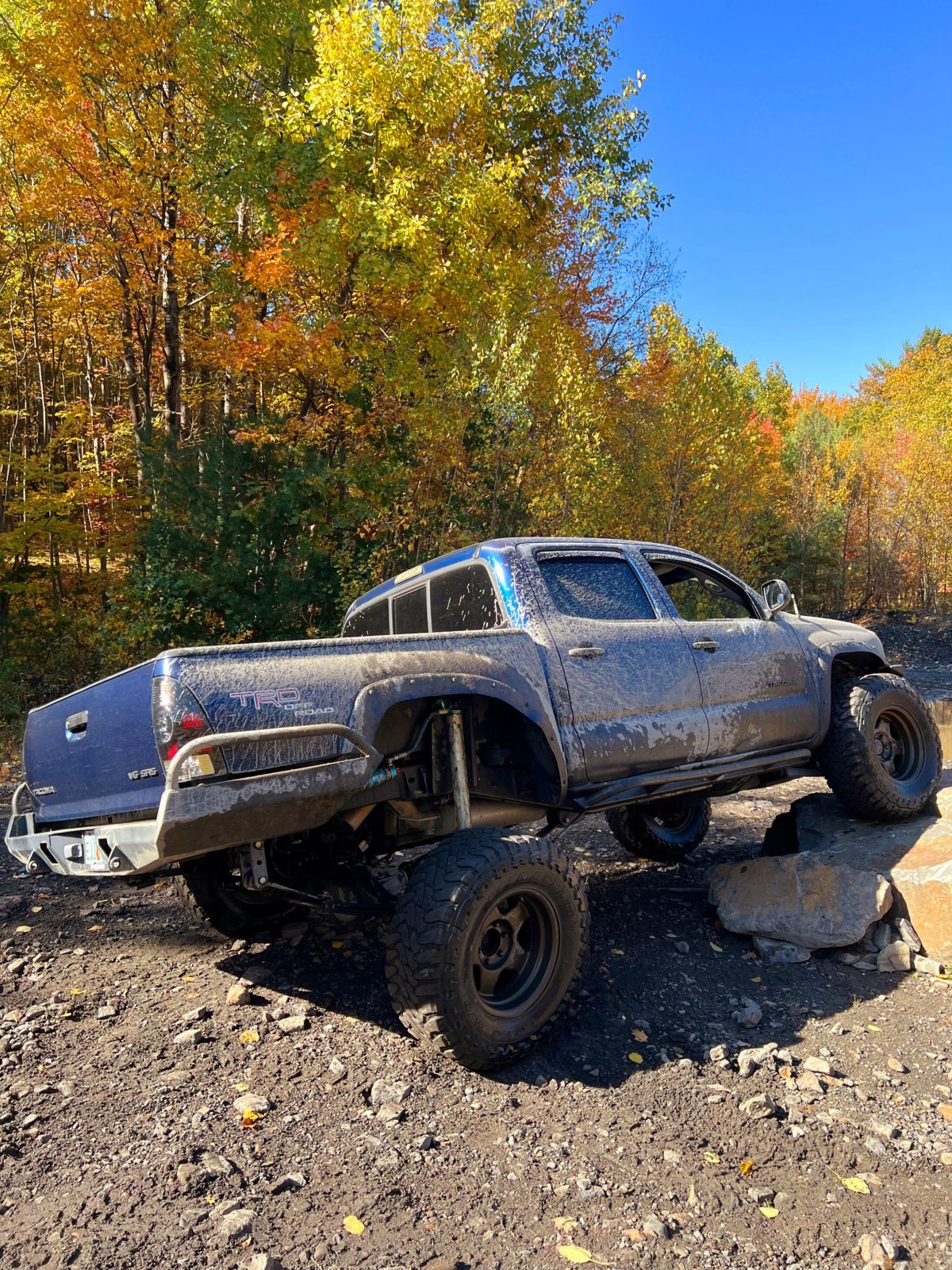

    Need to get some trail time in.

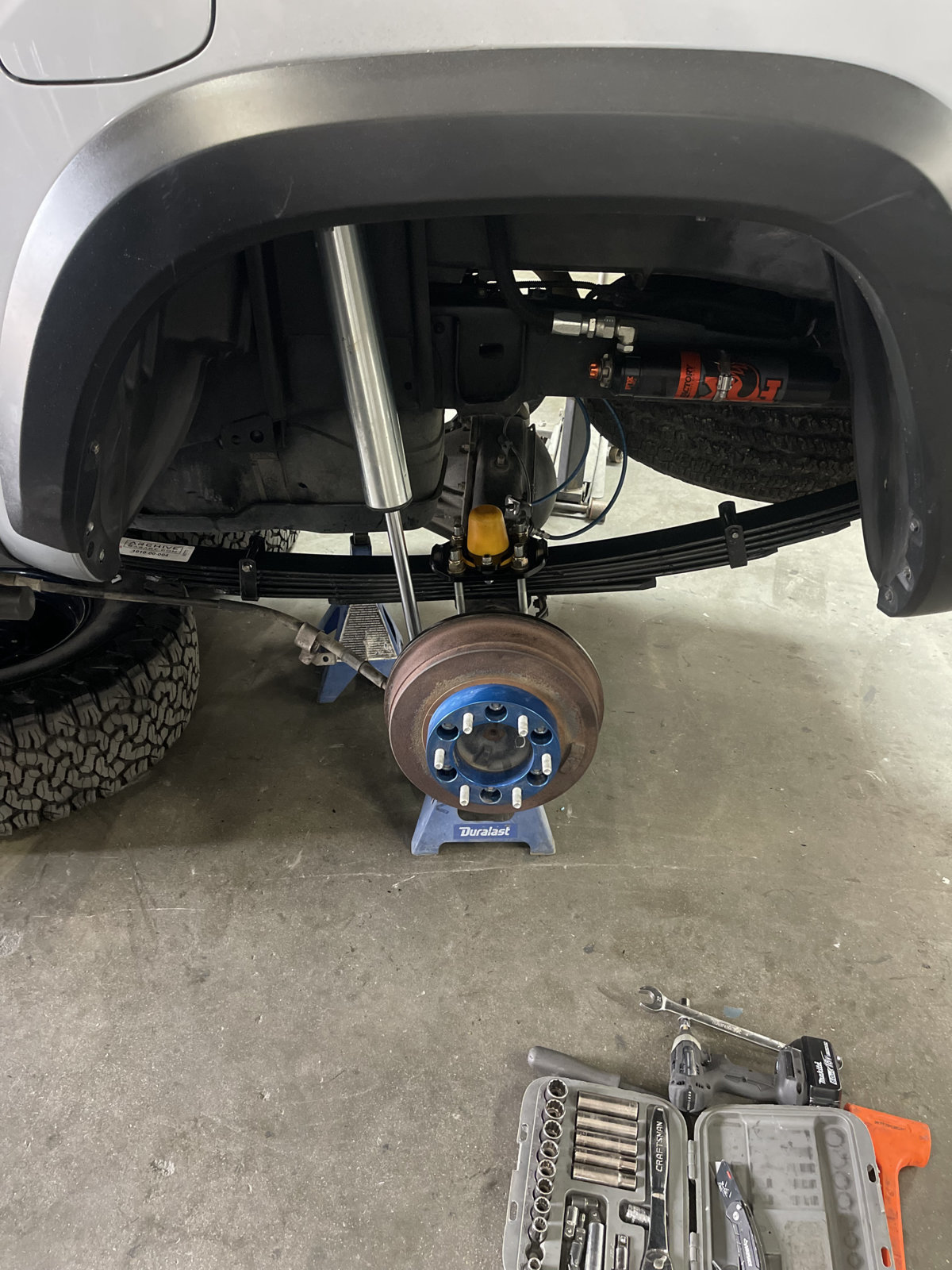

  13. Jul 8, 2024 at 5:46 PM
    #1153
    tacoman_13
    tacoman_13 Well-Known Member
    Jul 31, 2022
    #402570
    94
    Triston
    San Diego
    2007 TRD Off-Road
    JD Fab LT, Archive Garage Hammer Hangers, soon to be on 35's

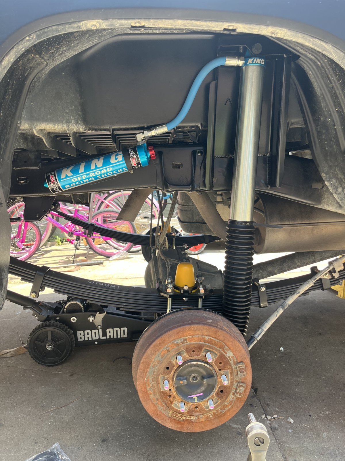

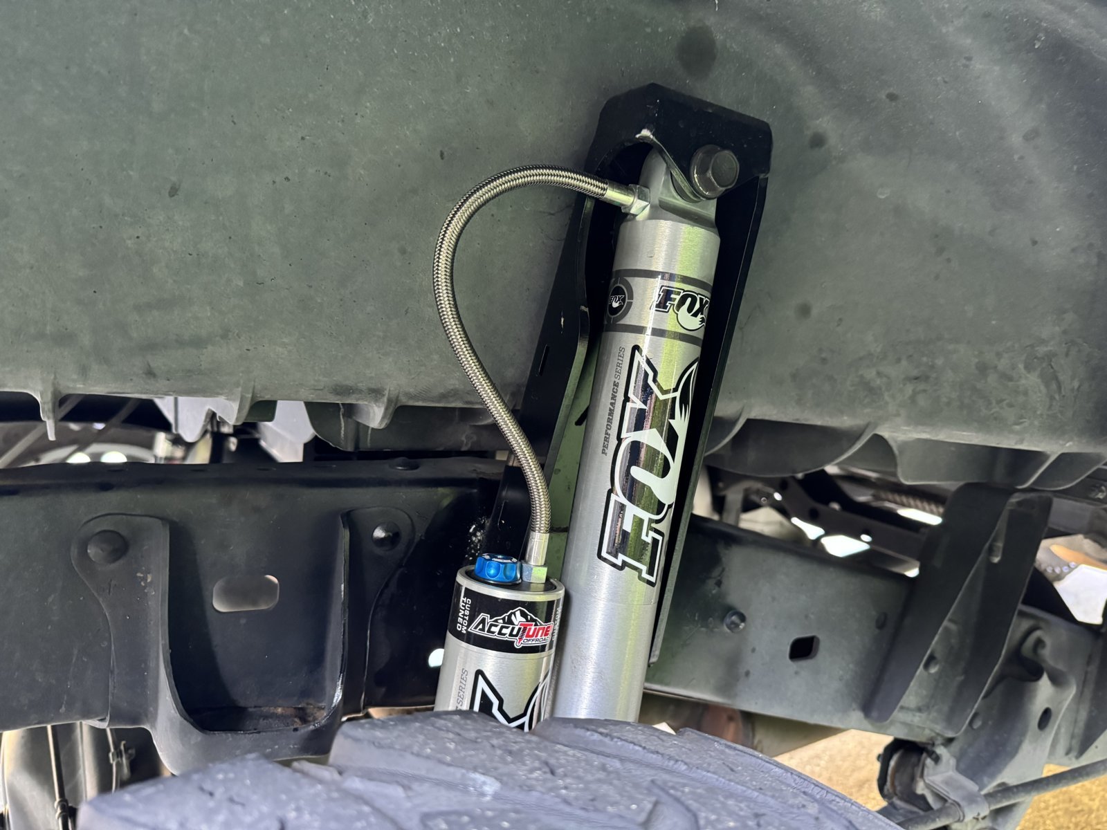

    Had my Archive kit put on today with some custom valved king 2.5x12 smoothies with adjusters. This is the current amount of up and down travel i was able to get out of it today. I am currently limited by my shocks kissing the shock body and my 1.25 spacers are already on the way. I still have about an inch of up and down travel remaining. Install time was about 5.5 hours for others to reference.

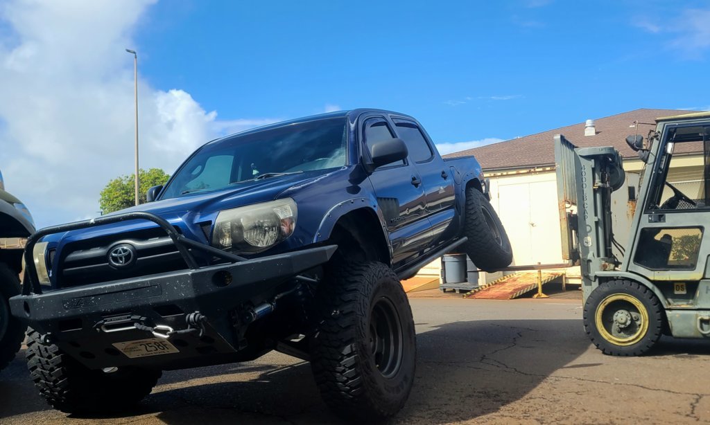

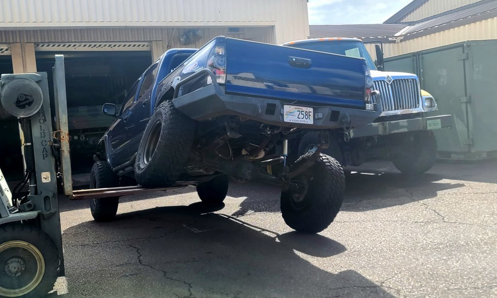

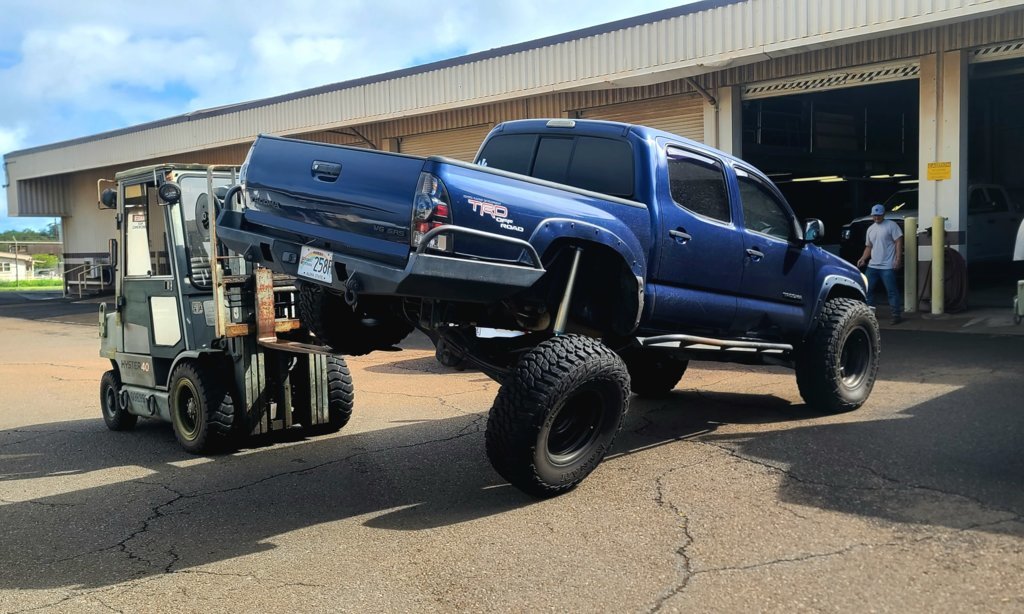

    Messed around on the forklift today

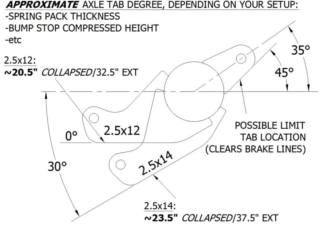

    KIT ALLOWS FULL BUMP W/ 2.5" X 14" (~23.5" COLLAPSED)!!!
    YOU DO NOT LOOSE BUMP TRAVEL
    Please take it from the designer of this kit, it was designed from the beginning to stuff 2.5 x 14" shocks (23.5" collapsed length), even with thin stock packs and stock bump stops.
