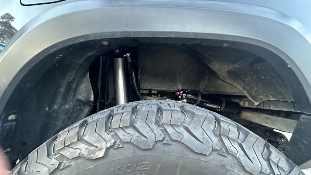

    Ok, I've done checking every post on 59 pages in one day and found a lot of good info. My case is very specific, I have a custom made truck camper. The wheel well has one inch overhang on the frame which is completely different if compared with Tacoma bed. And the height from the frame to the top of the wheel well is 10-3/4 inches at the potential location of the tower. I can lift the camper, it has subframe and already lifted about one inch and a half. May I ask to measure the top height of the relocation tower from the frame near the bump stop bracket(it will be the hi point of the frame due to the curve)? I've found one post about the height of the tower but it's not clear from which point. Also if it's possible the inclination of the tower. Thank you.

    @essjay @ARCHIVE maybe you can help
    I have some work to do to properly mount the camper, I will temporary remove bushings and would like to prepare for the relocation.

    My truck's been parked at my work all month, but I should be picking it up Friday or Saturday if we finally finish the job I'm on. If Eric hasn't gotten back to you by then, I'll get some measurements for you.

    Top of the frame to top of the relocation bracket is 10.5"
    The bracket leans outward 11°
