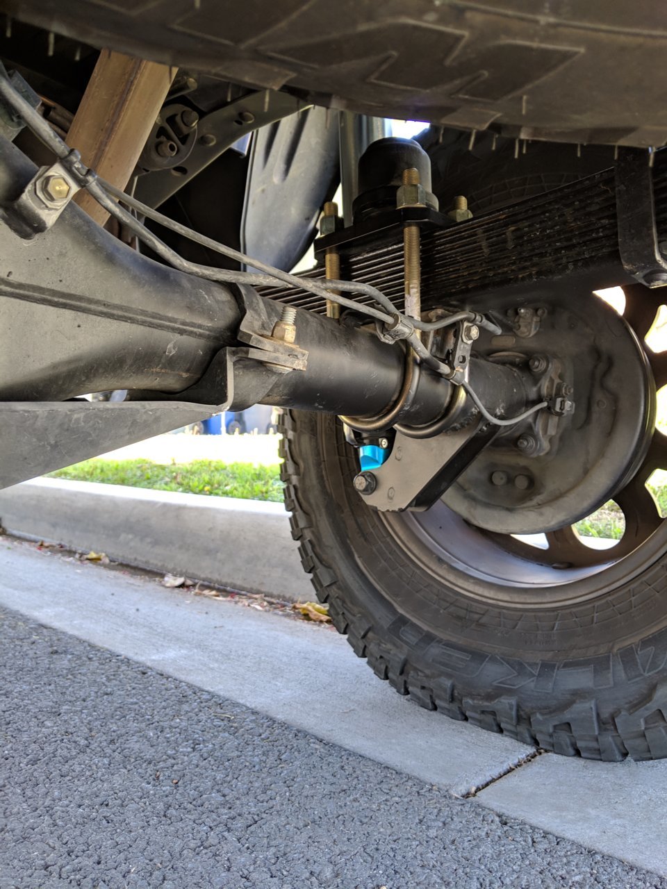

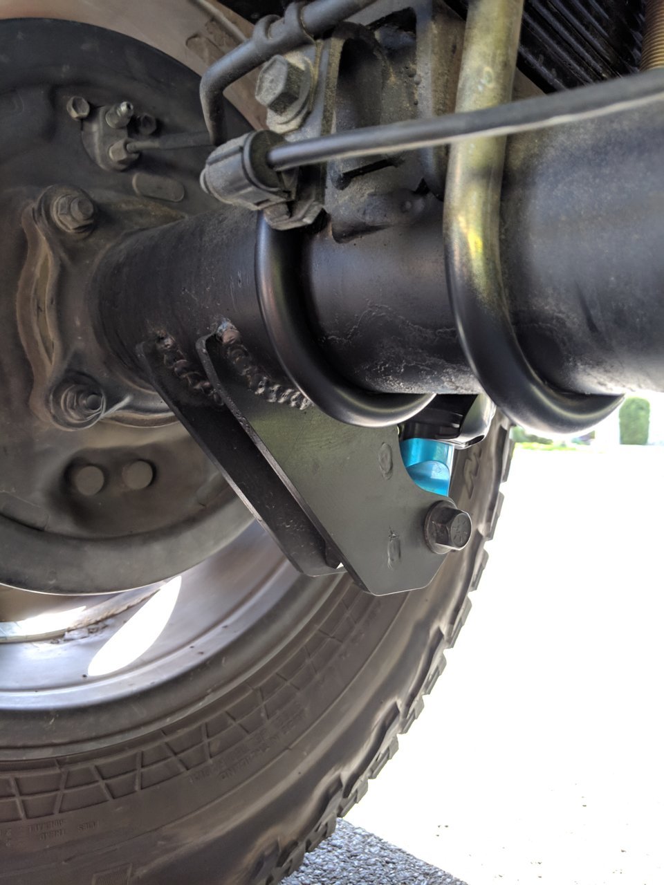

    I'm not sure why mine are so low below the axle looking at @Supra4x4 photos. Different lower shock mount? (I have the standard Archive mount tabs) 14" Shock
    Mayak1957 likes this.
