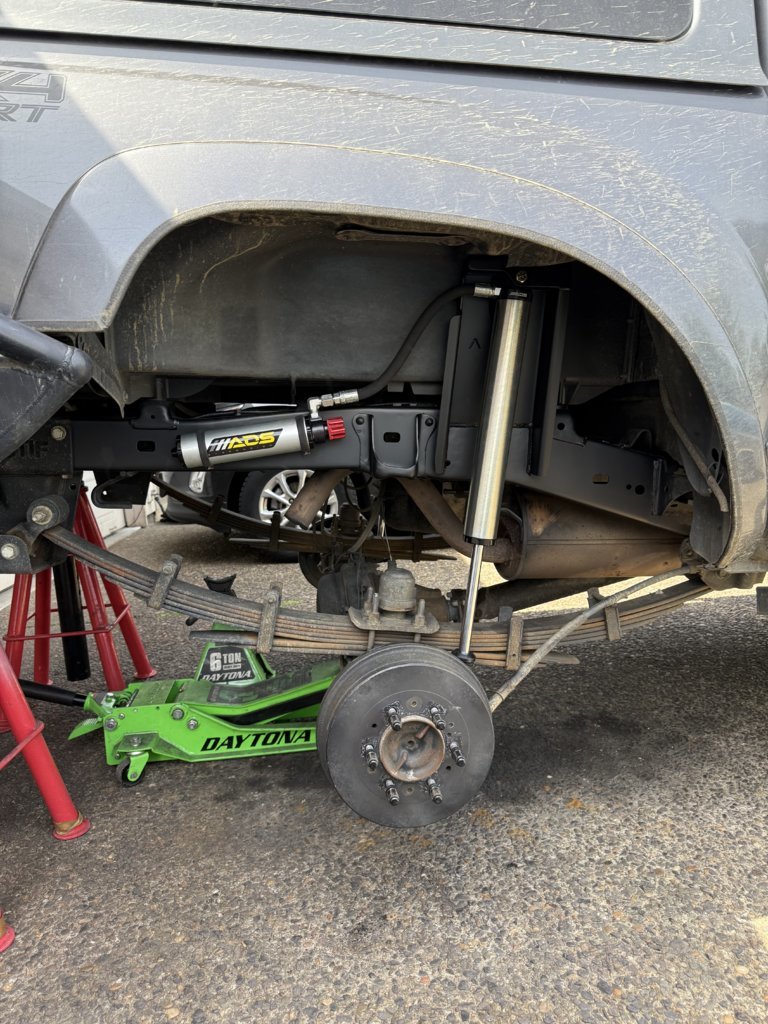

    What is the shock length you're running?

    Any spacers?

    I think he had 12" when the Pic was taken 4-5 years ago

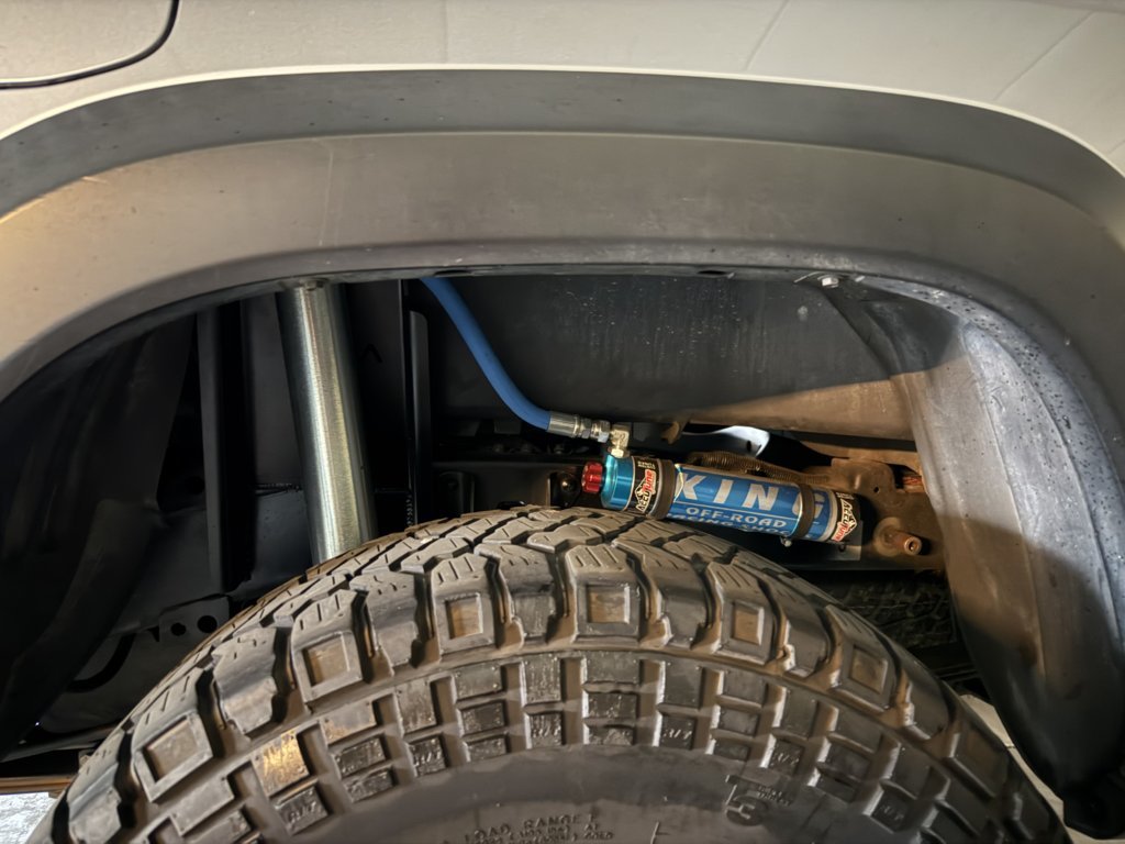

    Haven’t pasted mine yet, but joined the club a couple weeks ago. Paired with BAMF hangers. IMG_0112.jpg

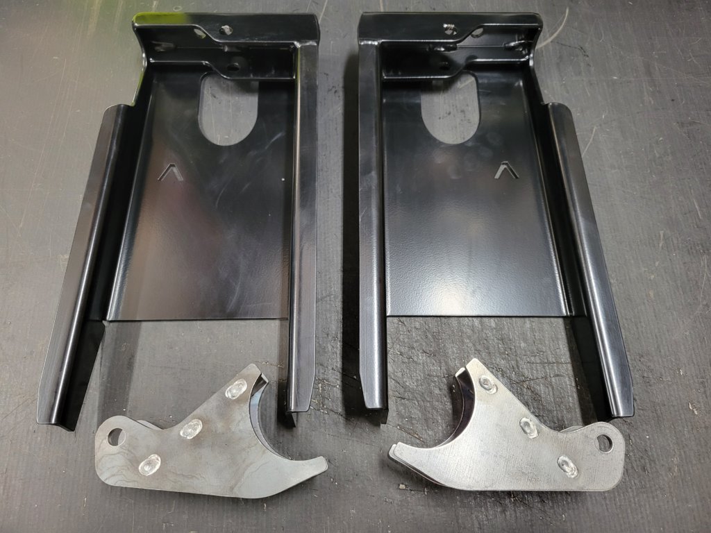

    We have 1 of these kits that was a display model, some rub marks in the powder, mainly on backside.
    $500 shipped as DC Short bed
    $520 shipped as Long bed
    Message me if you're interested

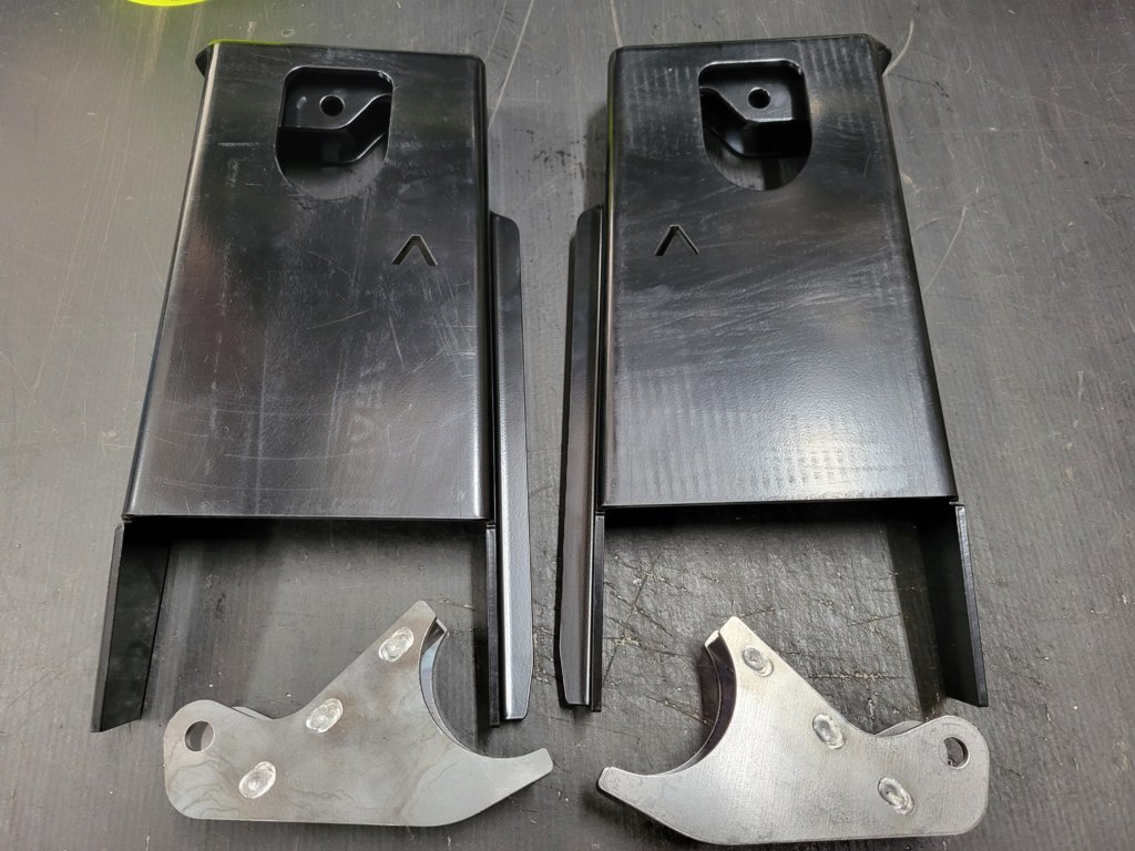

  17. Jun 20, 2025 at 12:13 PM
    #1237
    cwk84
    cwk84 Well-Known Member
    Feb 15, 2024
    #443895
    62
    2019 TRD OFF-ROAD
    That’s what I did and regretted it. 12“ is not enough travel. And the 14s require no additonal changes. They mount on the same shock towers from AG. I should have gone 14“ right from the get go
    Operator8 likes this.
  18. Jun 20, 2025 at 5:54 PM
    #1238
    mauctopa
    mauctopa Well-Known Member
    Jun 24, 2021
    #369477
    725
    That hits home hard, I was steered towards the 12s too but at the shop they told me I could have easily packaged 14s
  19. Jun 20, 2025 at 6:09 PM
    #1239
    cwk84
    Feb 15, 2024
    #443895
    62
    2019 TRD OFF-ROAD
    And you wanna know the best of it? The Icon RXT leaf pack barely achieves 11" of droop according to Accutune But even so, they could have advised me to get 14s and later on get a different leaf pack such as the Chevy 63 leafs which do allow for 14" of droop. Instead I went with 12s and only get 11" of travel lol. And with the Chevy 63 springs I would need limit straps with the 12s. So what did I do? Order 14s lol. This hobby just eats up my money man.
  20. Jun 21, 2025 at 10:33 AM
    #1240
    ARCHIVE
    ARCHIVE [OP] Well-Known Member Vendor
    Oct 29, 2015
    #168099
    2,253
    Eric
    Orchard Park, NY (Buffalo)
    '05 Taco, '22 Tundra, '91 Cummins
    2.5" Fox relocation * Hammer hanger * Archive MD springs
    Yeah, they even tell people 14" won't fit without hurting bump travel, completely untrue, despite numerous times of telling them.
    We designed this kit from the very beginning to run standard length 14" 23.4" collapsed length
