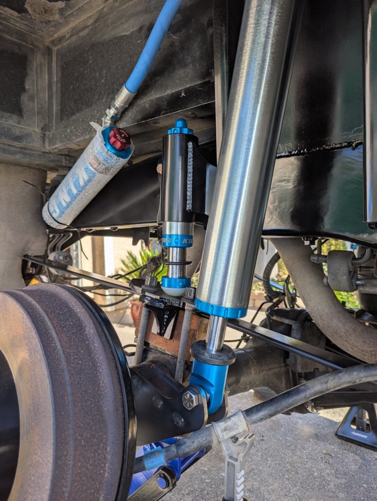

    Will a 2.0 x 14" shock fit with this kit? I know it is designed for 2.5, but looking to get 2.0's as they are cheaper and my shocks are on the way out

    Pretty sure they have a relocation kit specifically for 2.0s.

    They do. I'm wondering if a 2.0 shock would fit on this kit.

    I have the 2.5 kit installed but I need new shocks and 2.0's are much cheaper. My wheeling only needs 2.0's too

    Yes, the 2.0 will fit if as long as the length is in the range, would recommend a Fox 2.0 x 14" Performance series Remote Res valved by AccuTune.
    Hose is shorter on the 2.0s tho, you could use our stainless resi mounts and mount resi to rear leg of tower
    https://accutuneoffroad.com/product...formance-series-remote-reservoir-14-1-travel/

    I'm currently running 2.5 x 14 carbon technologies smooth bodies and found a smoking deal on King 2.0 x14 smooth bodies. I know the kings are slightly shorter but this should pose no issue, correct?
