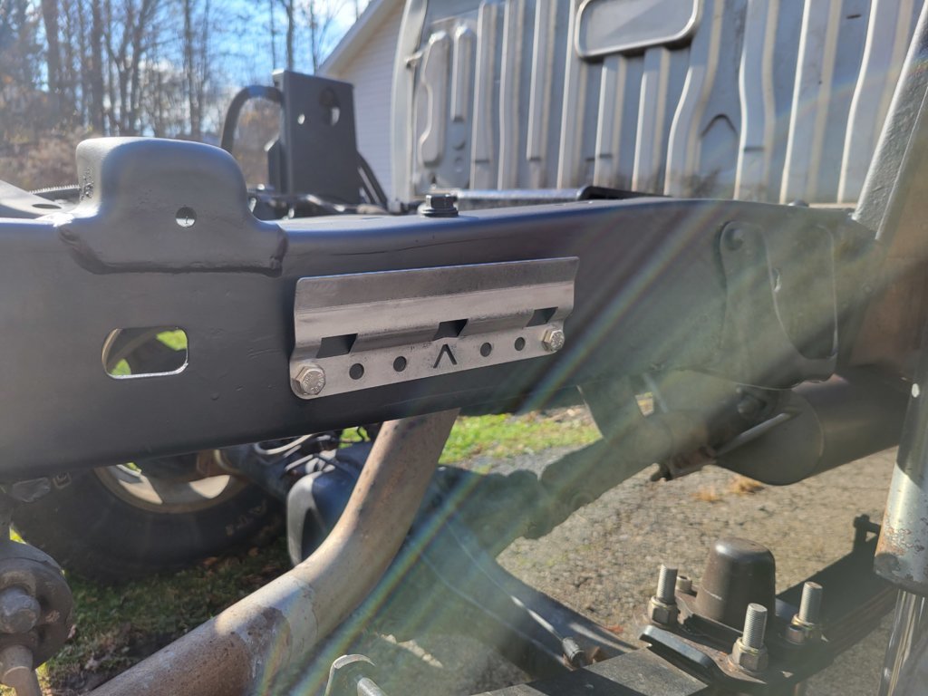

    Does anyone know the proper length for remote resi hose for king shocks to mount the resi parallel to the frame? I just can't do it sideways lol.
    Or if piggeyback resi is an option? Have not seen anyone use piggeyback tho.
    And is there any bolt on instead of weld on resi mounts?

    No, piggybacks do not fit, would contact rear leg of tower during articulation and axle moving around.
    Hose length I think around 18", which I think is standard for Fox, whatever comes stock on Fox it works.
    But king's standard hose is shorter like 16" overall I believe
    Archive 304 SS resi mounts
    https://archivegarage.com/products/shock-reservoir-mounts-304-stainless-pair
