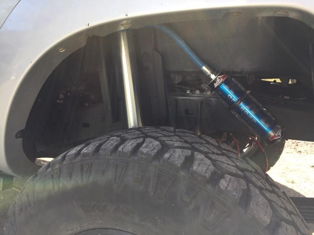

    ovrlndkull
    ovrlndkull STUKASFK - HC4LIFE
    Jan 7, 2017
    #206806
    37,785
    Skip
    Burlington, NC
    2005 DCLB Silver
    63s, XD Machete, Beat not Babied
    Whatever the stock length is for king I would get a little longer and maybe a 90 fitting at the resi. depending how you wanted to mount them. I did mine this weekend and wish I had gotten longer hoses. Now my truck is different as my Towers are 1" higher up than normal because I have a body lift. But even if I didn't I would want them longer so that there is more play in the hose and ability to mount better.
