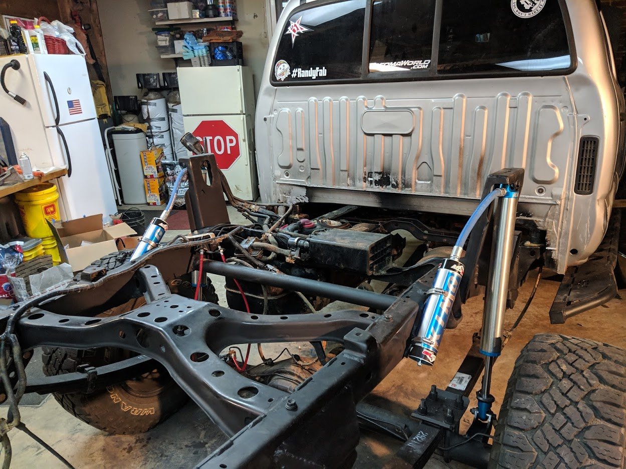

    You want to limit the travel to about 3/4-1/2" from full shock extension. Also getting under there and figuring out where you want to mount the straps is a good idea as well. Both myself and @EatSleepTacos put a tube across the frame above the axle to mount the straps too which is inboard so don't need as long of a strap. Also he is running BAMF relocation with the AG HH and 12" kings. If you are running stock hanger set up that is going to limit you quite a bit on droop and you may not even flex enough to need straps just yet. It is always better to test, measure, and apply what you need vs. going off a box stock set up because once you start doing stuff like this no 2 are exactly alike and it becomes harder to give a simple answer.

    Here’s mine. 14” from trail gear and that limits my shocks 1.5” from full extension (when up on a lift). It’ll stretch more than that while on the trail under load.

    Here is mine now my frame is fully boxed Randy just boxed a section to put the tube on. I used 2" .120 HREW for the tube. I need to order all the stuff to mount my straps haven't done that yet I got some straps from Randy that were too long for his set up just haven't measured and figured out where the mounts need to go yet. I am also running a 63 swap with 14" kings so mine are going to be longer.
