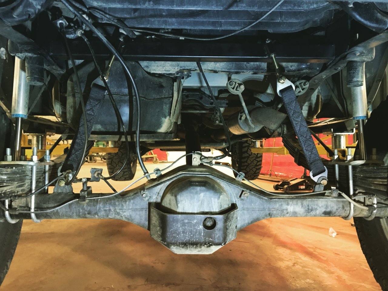

    Luv that diff “skid” u made there! Very clean! Didn’t even notice it till I started zooming in and looking at your set up

    2.5" Fox relocation * Hammer hanger * Archive MD springs
    You have stock shackles

    That’s from trail gear, about $50 and all 1/4”. Welds on! Works great.

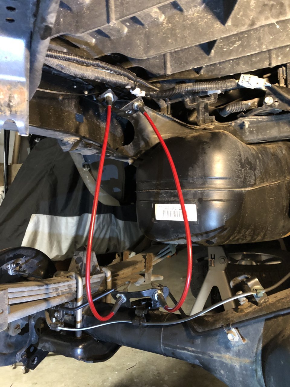

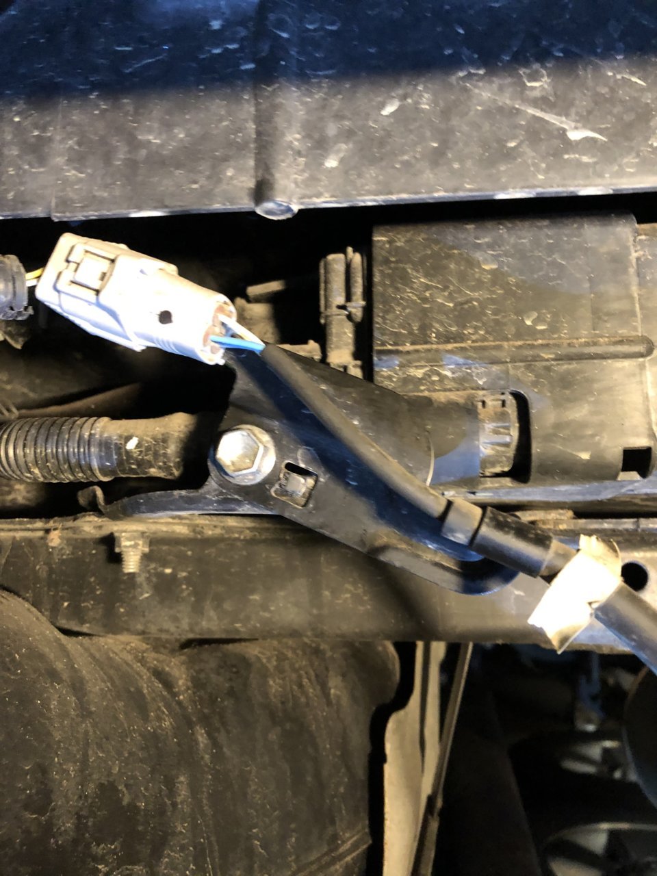

    I just installed extended brake lines in the rear and immediately noticed the ABS line is very tight. So I loosened the bracket and angled it down. What are other people doing with the ABS?
    I have been doing quite a bit of electrical work on the truck so I feel confident I could solder in a small extension just don’t know where I would get and extended rubber cover for the wire.

    I cut mine and added about 4” worth of wire. Just some soldering and heat shrink

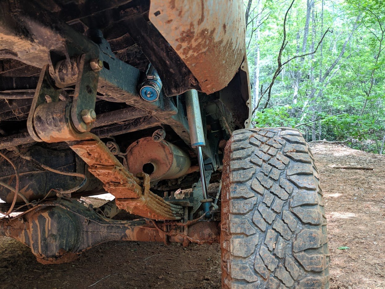

    Looks like we knew what we were doing. Took the truck out finally for some testing and measuring. Super happy where my bump landed but still missing a little bit of droop. Oh and no wheel rubbage!:bananadance:
    Specs are 1.5" Spacer with -12 offset wheels nets ~3" BS Shocks set at ~5* lean inward towards the top mount at static ride height, chevy 63" leafs, King 14" 2.5 RR. The spring is completely flat here, spring hangeris at ~10* anlge off the frame, and there is 1" of shock shaft left. I need to add bumpstops now but I got my measurement of were it should be. Couln't of ended up in a better position.

    I think I also rotated the bracket on the axle up

    I would do this but I don’t know where to source the protective wire insulation between the two clamps.
    This sounds easy. I’ll take a look tonight.
    Really rotating the top bracket down seemed to reduce the strain on the wire. But I would prefer a little more slack.

    I just have mine dangling took the bracket on the frame off and taped the connector up so I got some extra length.

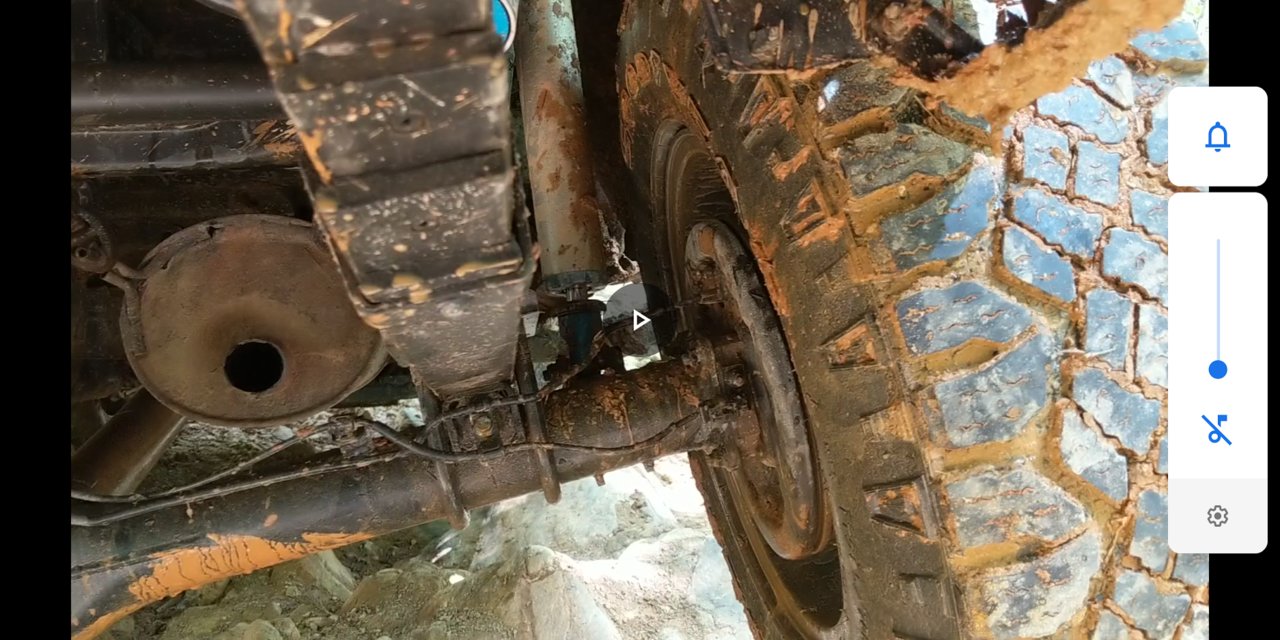

    Here are pics of where the shock mounts currently are and flexed out and at full bump. At full the chevy 63 leafs are flat. This pic where the 1/2" king shock bump stop is compressed some the leaf is a tad neg. flat it's about 3/4" from the shock completely bottomed out. Full droop the shock is the limiting factor and I still have a couple inches to droop down possibly. As you can see the lower shock mount the bolt is about 1" above the top of the axle tube. Don't hate too much right now I didn't do bumps or limit straps yet because like my shock mounting I wanted them to be optimum and not just wing it and see what happens. When we set mine up there was some math involved and a little dumb luck as well. (ignore the exhaust being cut off right at the muffler it was in the way for the tube for limit straps.)
    Full droop PS
    iL614pV7ZxOi_FUNzpBXiBzIU8xlW0tSme9oSKBV_69c78103f306935cec2d6edd8b4a1ae4201d6018.jpg
    DS little over full bump spring starting to go neg.
    PS full bump spring flat there is 3/4" of shock travel left
    bCK32-lnx_3im2B-qenUYs9ghfLM1JmKA-yYzRqs_ce3ac8cc84a97f0f16b6d4b7a7955df883350ddf.jpg
    DS full droop
    PYBRGBINYcp4MVjd76VVNWcayDY05jzZ3Xr0x5sY_d499a8ba251d179a5bf4106b0ed82b0293f7eeed.jpg
