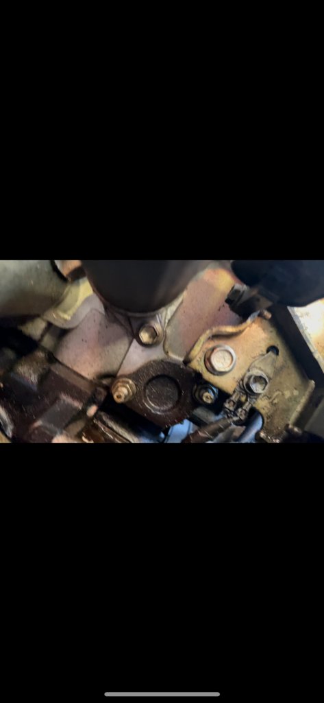

    Hi I got a 97 tacoma 3rz I’ve had an oil leak for awhile now I believe it’s coming from the timing chain tensioner has anyone ever replaced or had the same leak ?

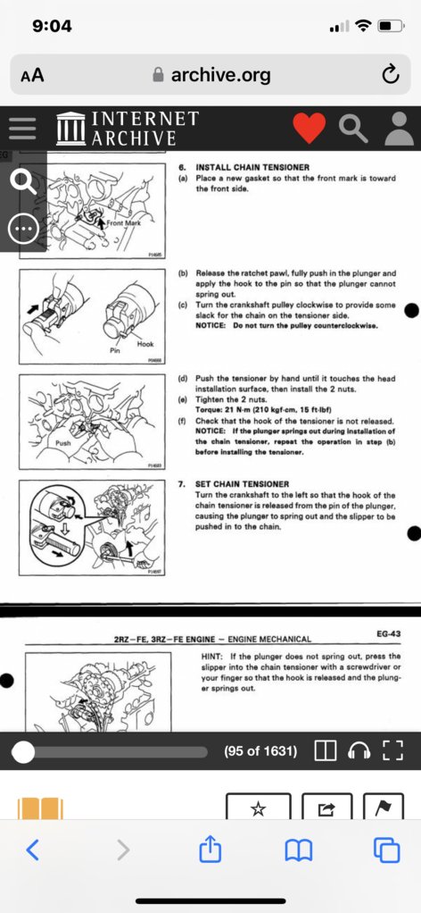

    I’m guessing that replacing gasket/tensioner can be done w/out removing everything
    Unclear, bc this pix is comes from a T chain install list of instructions
    hopefully another member can confirm
    2 bolt job or much more labor needed

    O'Silver_Taco
    O'Silver_Taco Well-Known Member
    Aug 26, 2021
    #375390
    4,198
    MD
    98 Dlx Sr5 ext AT Rwd
    3rz to 2Rz bebuilt block and new heads
    ControlCar likes this.

    That’s much better than taking T cover off!!

    I did mine without taking valve cover off. May want to check distributor ( o ring) for leaks too. Both are same side and close to each other. And also the oil filter mount. It has two o rings. All are easy fixes, so a little research on you tube and here as already suggested. The reason I advise to check all three is because I did not. Fixed one then found still had a slight leak, then next fix etc. a good cleaning and paying attention would have netted it all for me at one shot. Good luck.

    You never had to mess with timing correct ?

    If THatt did the install w/out valve cover off……then no
    but need to follow those ‘set tensioner’
    Instructions

    No
    Nope, didn’t have to mess with timing. Just be sure to listen for that click when you rotate the crank.

    awesome thank you for the info did you rotate the crank backwards like the manual states ?

    It’s been a while so forgive me on the fine details. I followed the directions carefully. There was an audible click when the hook released.
