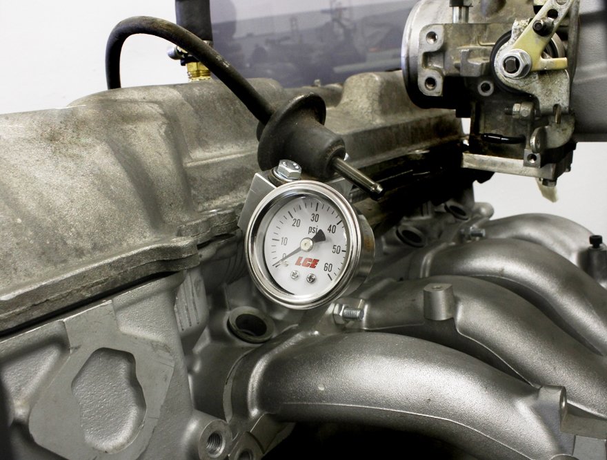

  7. Oct 4, 2022 at 7:52 AM
    #27
    O'Silver_Taco
    O'Silver_Taco Well-Known Member
    Aug 26, 2021
    #375390
    4,207
    MD
    98 Dlx Sr5 ext AT Rwd
    3rz to 2Rz bebuilt block and new heads
    heres one...disreguard the gauge...
    BigBaby[OP] likes this.
  8. Oct 4, 2022 at 8:00 AM
    #28
    BigBaby
    BigBaby [OP] Well-Known Member
    Aug 14, 2022
    #403532
    63
    2001 Tacoma Single Cab
    Terrible
    Man yeah, that sucks I'm sorry. If it comes down to that kind of money for my truck I'm just gonna sell it, I haven't had it for long enough that it feels like it's worth it to me to keep it. Not sure what money I'm willing to spend on it right now but it's not so much lol.
    Thanks for the pic I will check that out as soon as I get the chance.

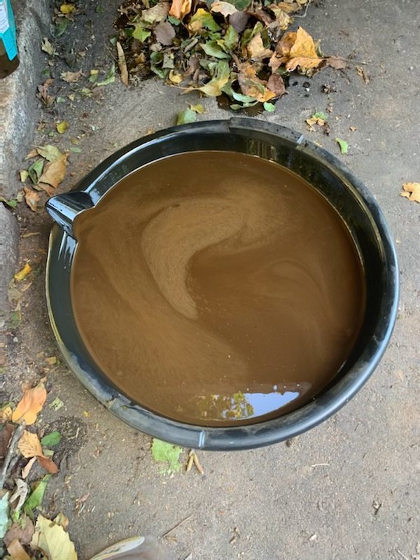

  14. Oct 4, 2022 at 2:45 PM
    #34
    BigBaby
    Aug 14, 2022
    #403532
    63
    Terrible
    This is the oil. My dad was able to drain it today. I am not optimistic lol.
