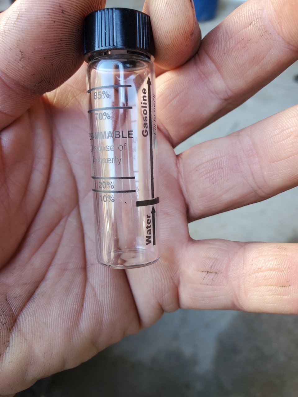

    Anything with a vented fuel tank (like outdoor power equipment, generators, and ATVs) has nothing but problems with ethanol blended gas unless you use them every day as ethanol pulls moisture from the air and separates from the fuel leaving the gas on top and the ethanol/water mix on the bottom.
    You can test your fuels ethanol content with an ethanol tester like this, you put water up to the line and fill the rest with fuel, shake it up, let it sit for a min, and where the separation line settles is your ethanol content.
