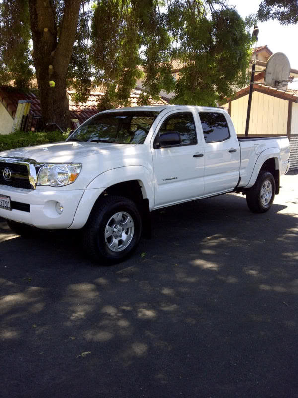

    That's what I did over the weekend. Came out great and the ride is awesome! I also added Icon 3 Leaf Progressive AAL's in the back. I wanted to keep a stock rake and I think it's just about right. I also added LR UCA's just to make sure that my alignment comes out fine on Thursday.

    I was in the same boat. Collecting parts for about 3 weeks. First shocks and the aal. Then, read some more and picked up the arms and springs. Finally, the 1/4" spacer and carrier bearing spacer. Then one day I said enough and just put the parts on!

    So, turns out that I probably didn't need the arms. Alignment came in at 2.9 degrees caster left and right, 0.3 degrees camber and 0.0 toe. They didn't fuss with upper ball joint of the LR Arms to reduce it, but it drives nice so I'm happy. No vibrations and drives just like stock. Good stuff.

    Just by having the LR UCA's at their neutral setting adds 2* of caster

    True.
    It was the least caster they could get without messing with the settings on the arms so I told them to leave it. They could have gone up to almost 4 degrees without touching the ucas according to the tech. I'm glad I did get the arms though. Made the alignment a no-brainer. Over all, the truck rides way better than before. Much more controllable and smoother over rough roads.
