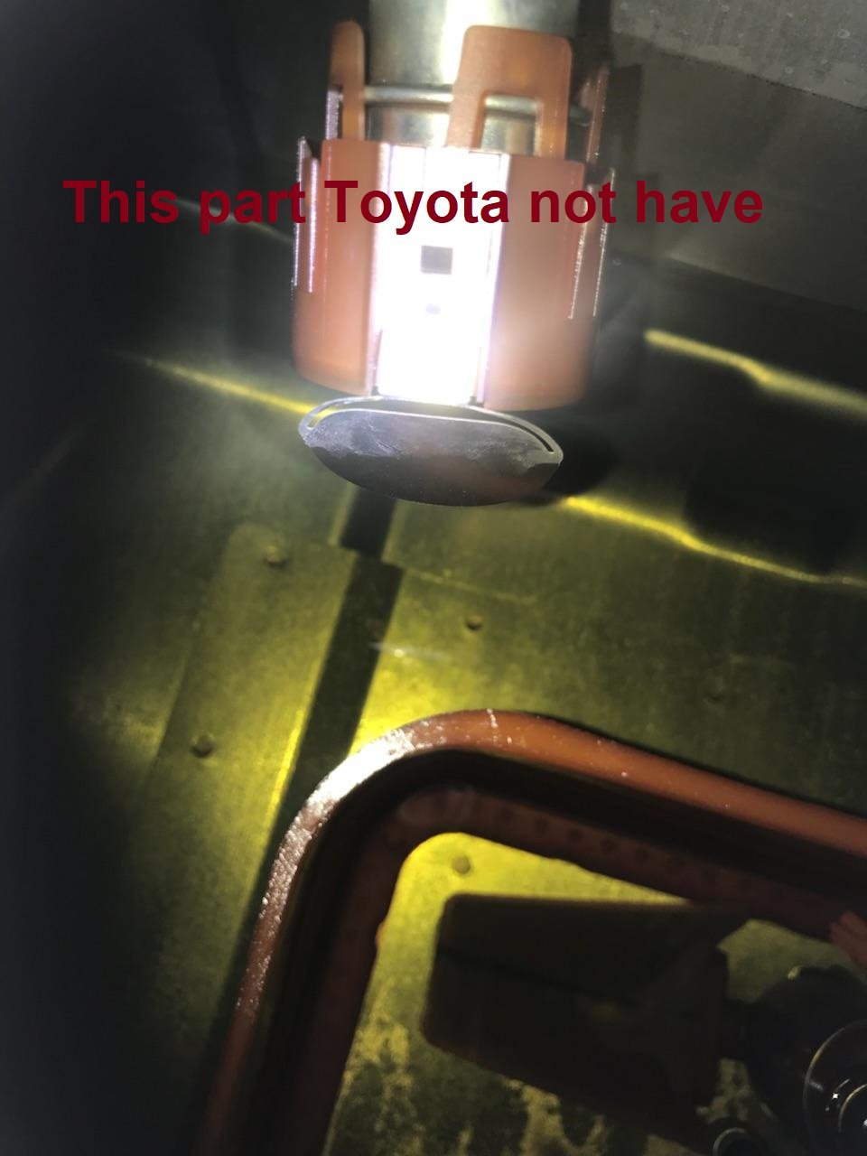

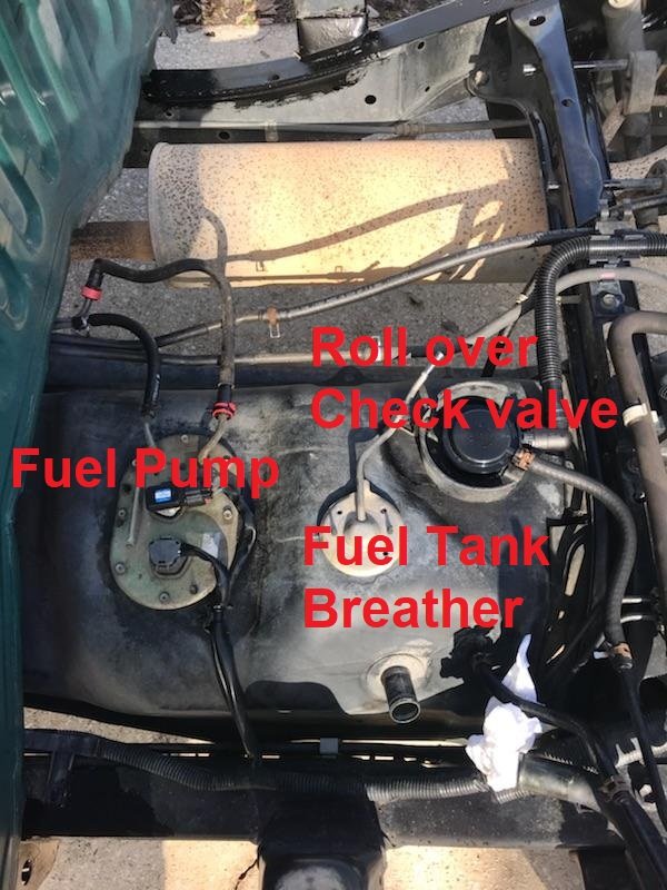

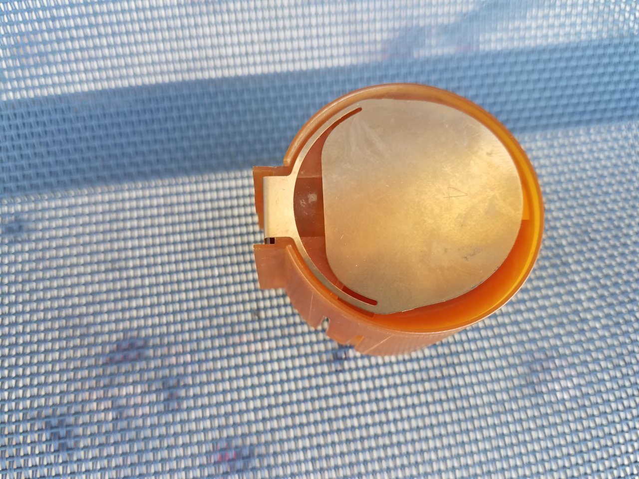

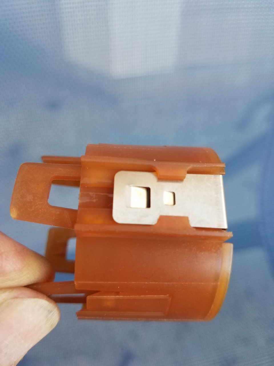

    My Problem when Fueling the fuel nozzle keep clicking off ever 5 or 6 seconds, This let me to headaches would not go down the filler pipe fast. I took the bed off so I could get to everything easy. I replaced the Roll over check valve part 77390 35010 and the gasket.
    Took off The charcoal canister took off both valve and tested them and looked at the canister all was good put the back on when to put a couple dollars of gas still clicking off ever couple second went back and Now with out the bed on I pulled off the rubber elbow on the filler pipe going into the tank and used a flash light and looked into the found the problem The filler pipe extends about 3 or 4 INCHES in the tank Their is a cap on the end that was stuck closed the gas would not open when gas Hit it to pass into the tank. causing the nozzle to click off This part is the ONLY PART THAT TOYOTA CAN NOT GET OR FIND A PART NUMBER for it and they can not order
    so I had to remover it and repair it best that I could. Everything is find now Fuel it fast and easy.
    To Remove that part here is how
    1 Remove the Fuel tank Breather 4 screws it is easy (on Top of That Tank) You remove this so as you can see inside the tank you at the part
    2 Remove the fuel pump assembly so you get you hand inside the tank
    The part is plastic and slide on and off it has snap clips to hold it in place I bend the tin end piece out on mine to open it the pulled it off the to make it flush It need to fit flush Mine was stuck closed pushed it with a screw and bent it.
