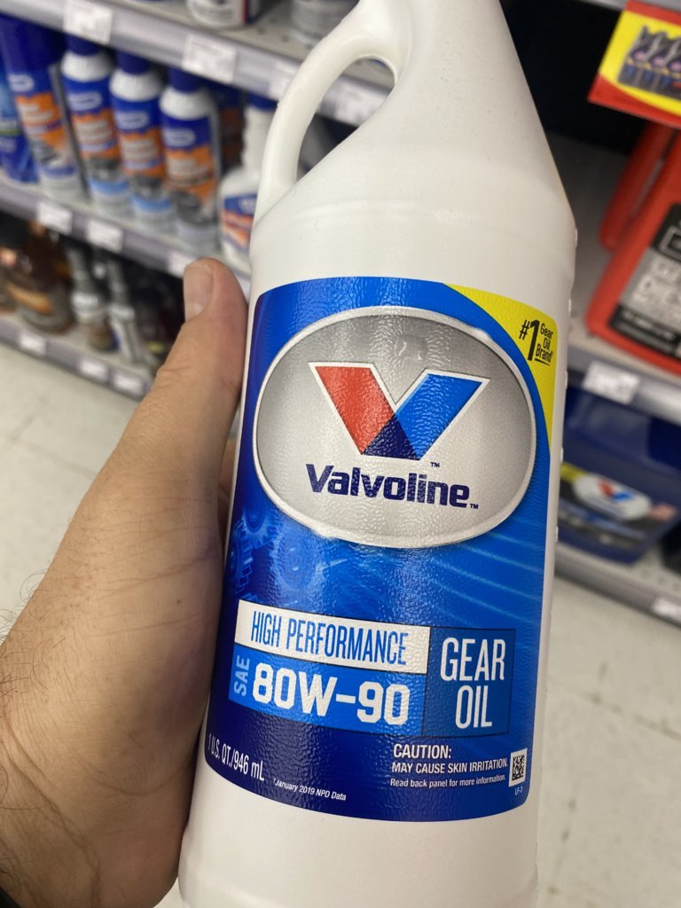

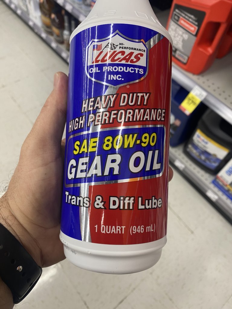

    Now, rear differential fluid, not sure the correct grade, any ideas?
    I believe 80w-90 but jot sure. Any ideas?
    I found some options here at the auto parts, will be performing the work today.
    Suggestions please?

    I used the Lucas 80W-90. Buy the gallon jug - should be cheaper than 4 individual quarts.

    So 80w-90 is the correct grade

    It's what was specified for my '96. I believe Toyota changed the spec a few years later to 75W-90. Not much difference and because you live in a warmer climate, 80W-90 would be fine. Many of the 75W-90 lubes are synthetics, which will be a bit pricier.
