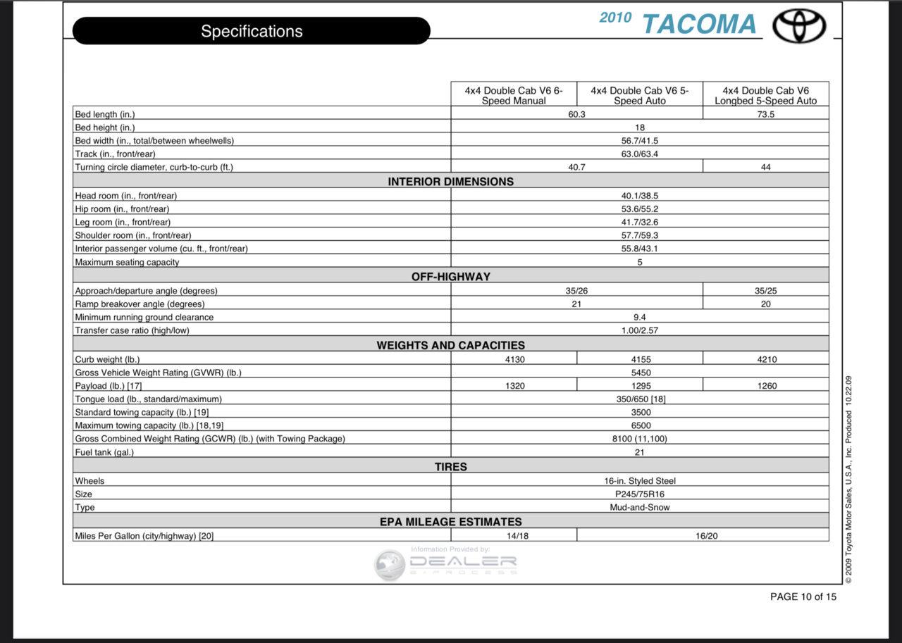

    How much weight can a Tacoma 4*4, double cabin, 2010, can handle?

    About 1,200 lbs according to this.
    Yes, it will carry more. NO, I wouldn’t recommend it. (Because recommending something unsafe “ain’t cool” -Just say no to being over weight:thumbsup:)

    Unofficially... 2500 lbs anyway. (with more leaf springs)
