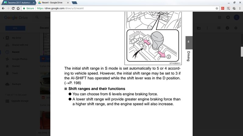

  10. Jan 30, 2017 at 7:02 PM
    daddy_o
    daddy_o Well-Known Member
    Nov 1, 2015
    #168380
    5,472
    Bossier City, La
    2018 TRD Sport, Inferno, w/tech package
    Factory Blackout package, Soft roll up bed cover, Cheap seat covers, Front and rear dash cam, AVS in channel vent visors

    Guy's it's not this confusing. S4 means you will not go into 5th or 6th...S4 means 4th gear is the highest gear allowed. Each number selected is the highest allowed gear and if used sequentially, allows some manual control over the transmission.
    Lt_Dan likes this.
