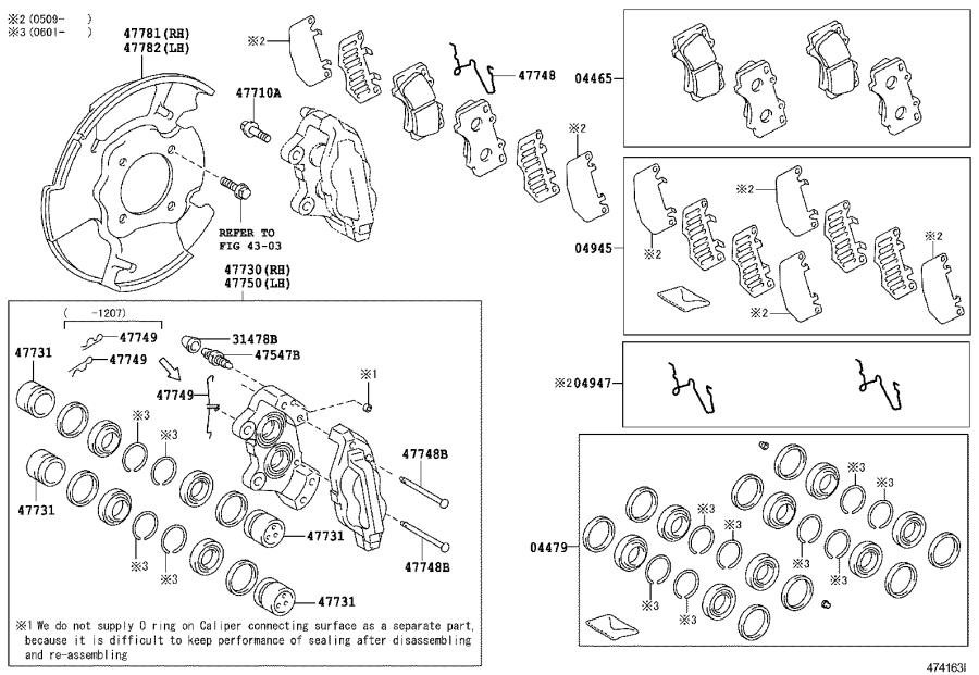

    i spent a total of $120 in parts for front pads/springs/pins/bolts and did it myself in about an hour, one of the easiest brake jobs i have done, 65k on the front pads and have not replaced the rear shoes since they usually last much longer, will check the next time i rotate tires. watch videos on it and do it yourself.
    check here for parts diagram
