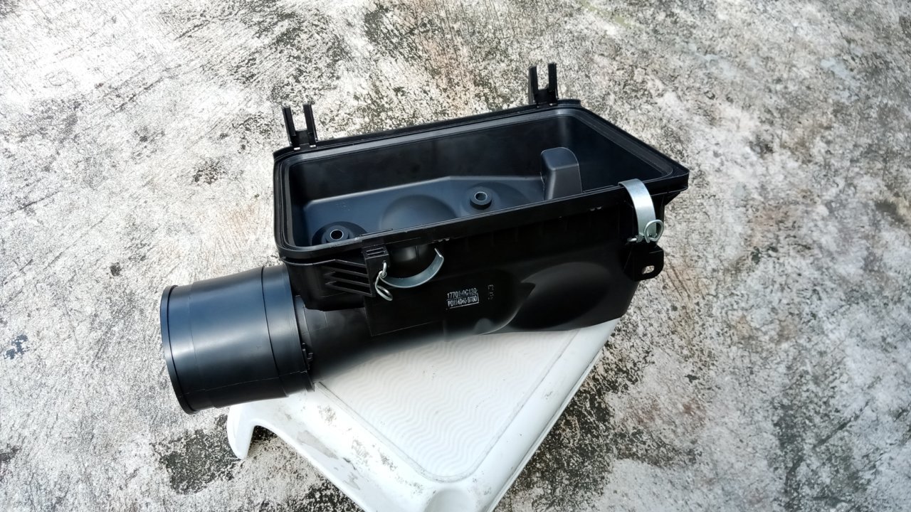

    2019 taco 2.7L thinking on removing inner fender 90% elbow and box. (inner liner box only) for less restrictive air flow and better throttle response....

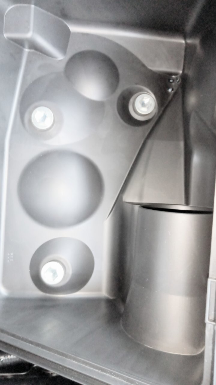

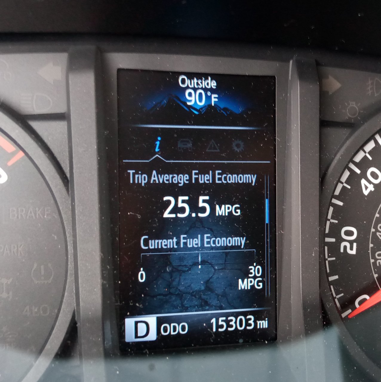

    well did mod....on taco 2.7L...better throttle response on take off. even better with ect on. rain like hell this weekend and no water entry into air box...very happy but the best was this i got 25.5 mpg on highway with ect on and windows down! i was like...wtf...fucking happy...never did better than 21 mpg before mod...and reminder i have bigger tires than stock. look at pics....IMG_20200920_140821~2.jpg

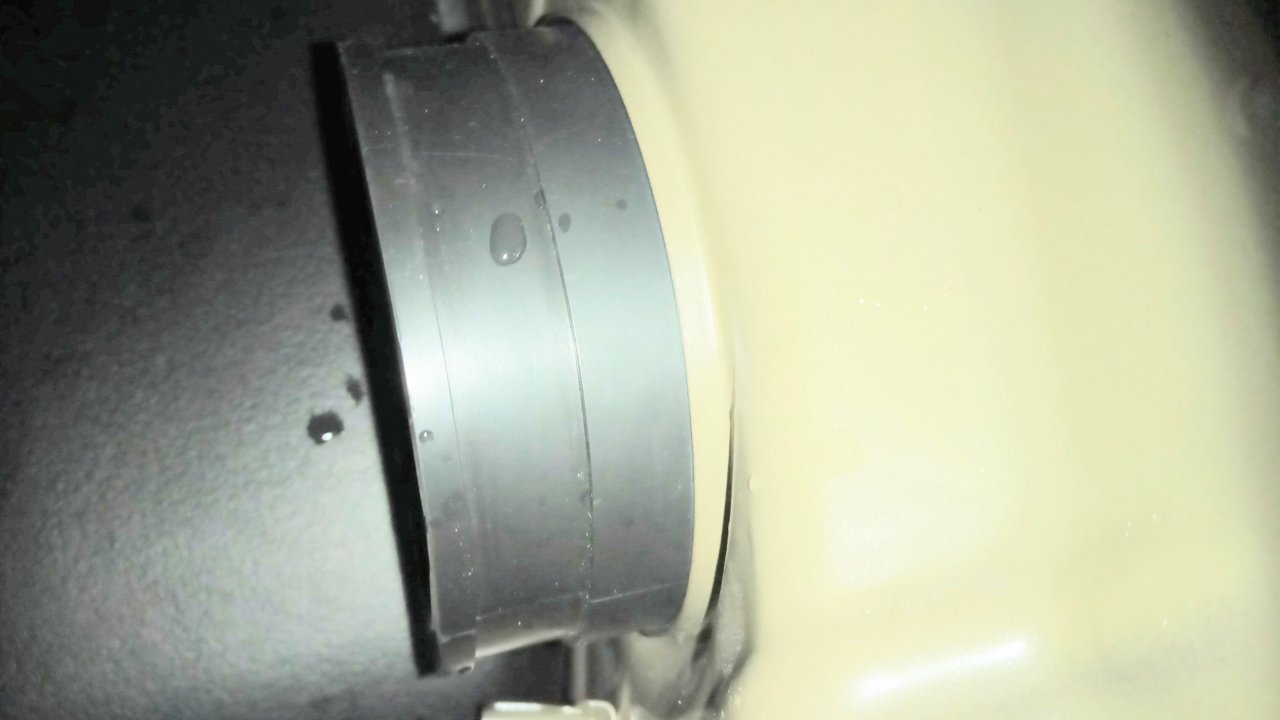

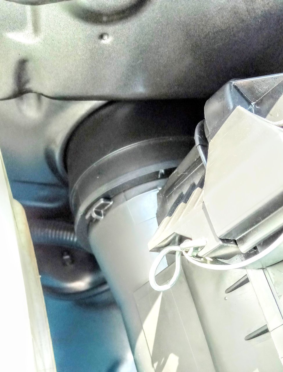

    pic of inside airbox tube to ouside fender holeIMG_20200920_142949~4.jpg ...no water entry

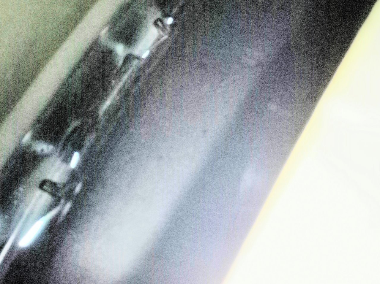

    inside view of fender....couple of drops of water on bottom of fender well...and on top rubber gasket i used....but no entry...bought longer gasket so if water came thru groumet holes it would hit the bottom of gasket...IMG_20200920_144025~3.jpg

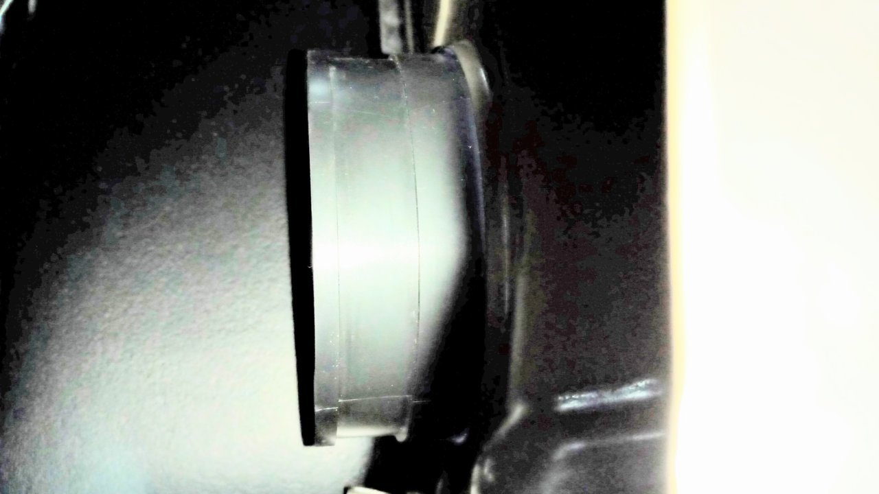

    bought 3" thick rubber gasket used on pvc piping...thicker than oem one and fit snug tight in fender hole....and is 4" long 1" longer than stock....

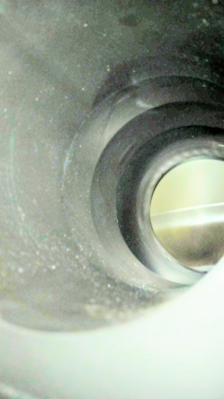

    inside fender well...note sun coming thru groumet holes...only area i see water could splash thru...but overall DRY!!!IMG_20200920_144041~5.jpg

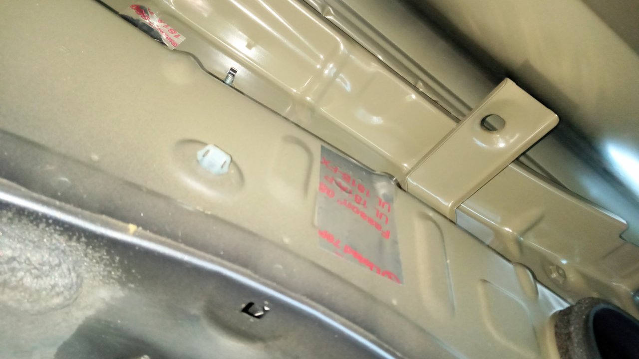

    also covered up holes from engine bay that were open...with a/c tape to prevent any heat or water from come in...IMG_20200919_084915~2.jpg

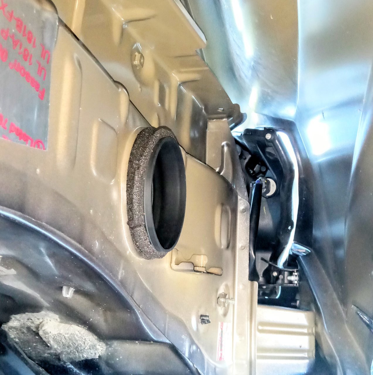

    view from inner fender before installed longer rubber gasket. newer gasket is a lil over 1" longer and much thicker...
    note there plenty of room between intake hole and fender....
    btw...taco is 2019 with 15000 miles and note the inside fender is very clean...

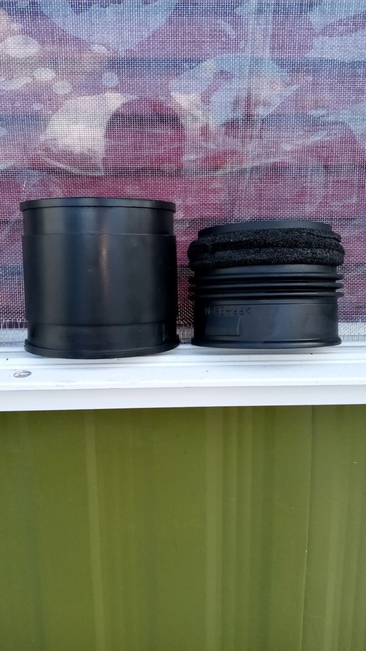

    this is how much new rubber gasket sticks out....if in the future i do notice water in the airbox...very easy fix by adding a short up turn ext..
    but dont think ill have problems...
    trd cold air intakes have a similar set up from factory or kit with a rubber piece called a air accelerator.... with no problemsIMG_20200919_125759~4.jpg

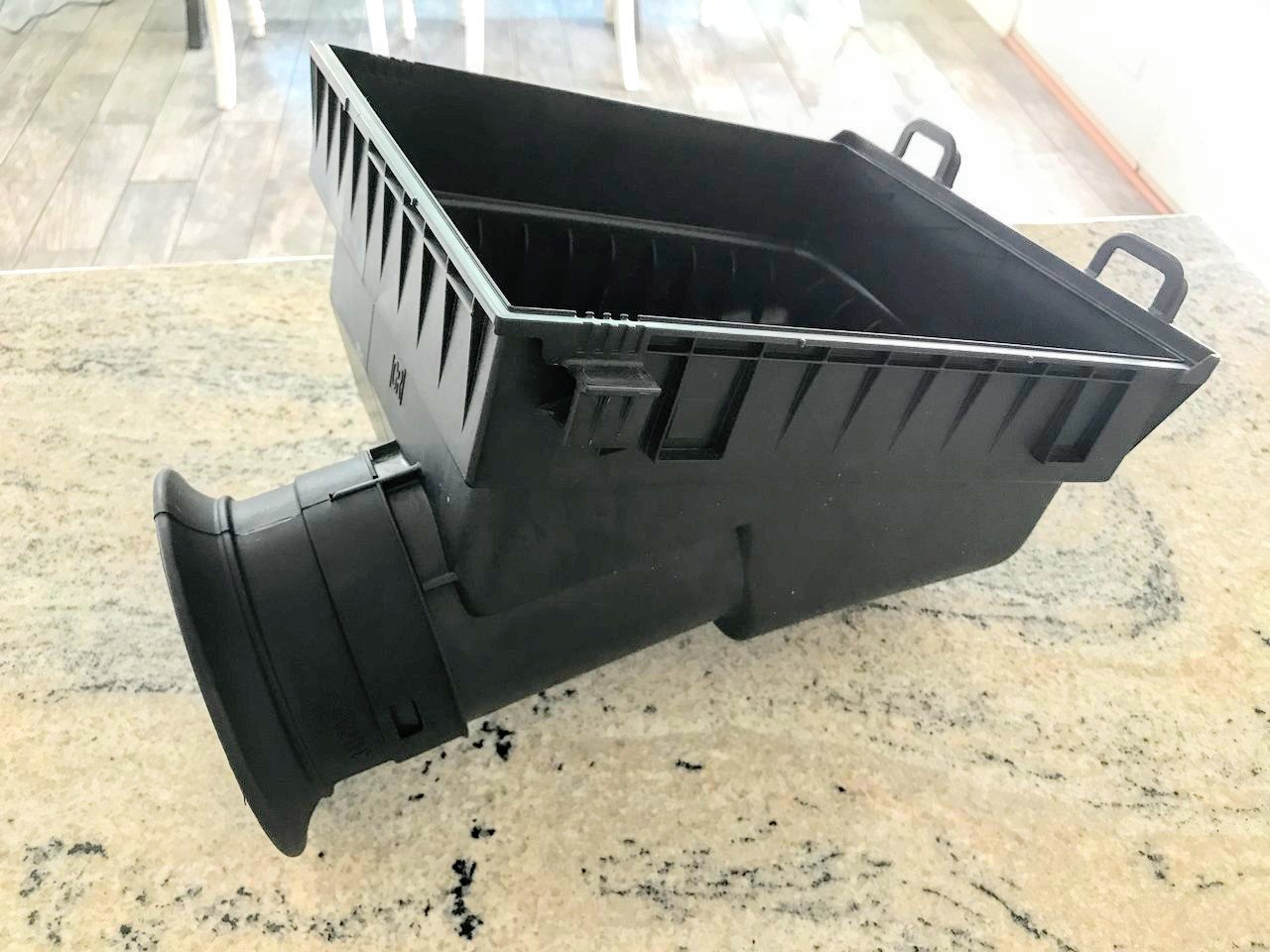

    I’ve had the same done for a while removed the charcoal filter from the top of the air box, removed the elbow, and put a trd accelerator in place and a afe drop in filter. Zero issues it feels smoother, there is no downsides I see
