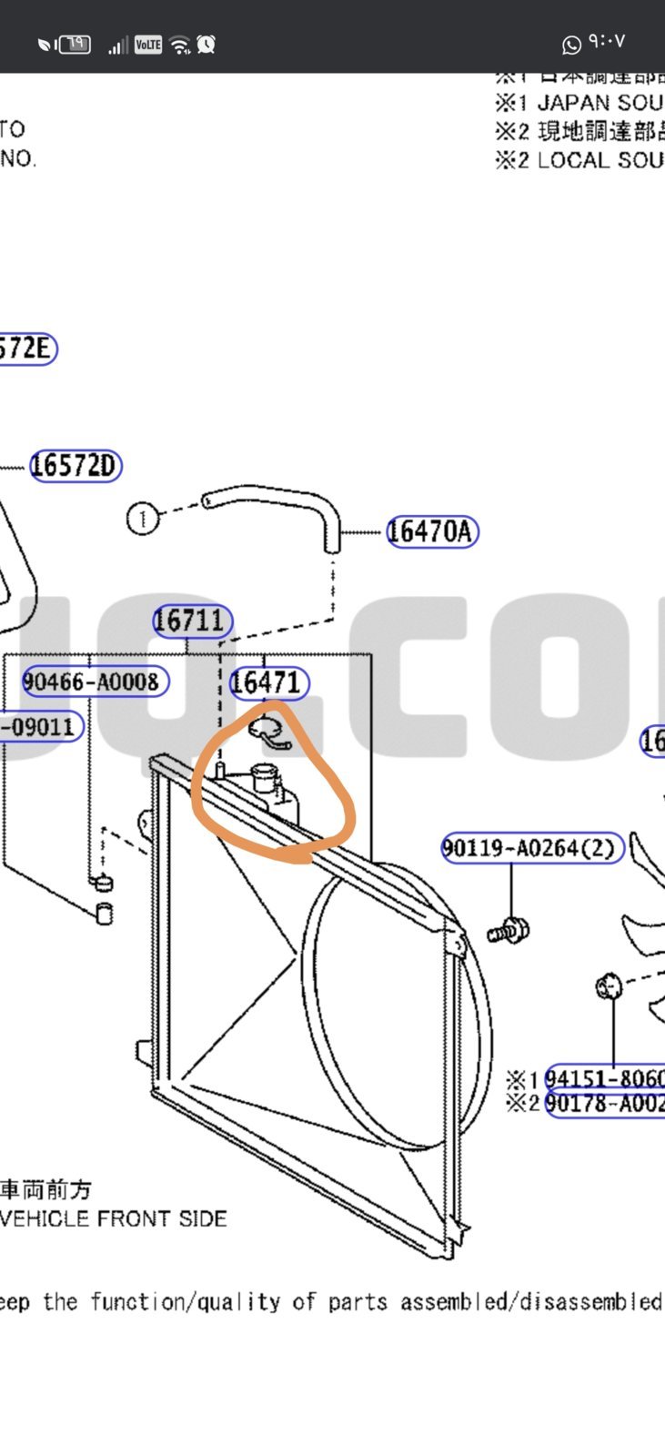

    I wish all doing well. Ihave tacoma2018 i have leak in the over flow coolent Bottle as attached. Any one can advise the part number or altrntv to it

    Are you sure it's not the cap/plug at the bottom or hose connection at the top leaking?
    The reservoir is part of the fan shroud and not serviced separately.

    Iam sure it is the Bottle as i see the crack and test it outside the cover.
