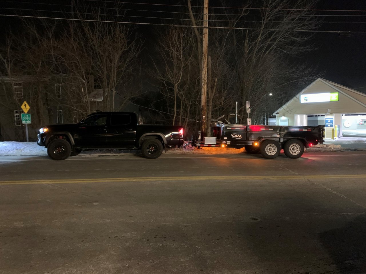

    Hello Everyone,
    I tagged onto an older tread last night and wanted to post this fresh to gain more opinions on the setup. I'm new to the Tacoma World forum and look forward to chatting with everyone. I purchased a leftover 2019 Tacoma pro last fall (Portsmouth NH Toyota) and have thoroughly enjoyed my time thus far with the Tacoma (lots of fun). In preparation for some yard work this spring, and equipment transportation needs, I purchased a Cam Superline dump trailer (with built-in pull-out ramps!). Specifically, I was thinking about mulch (5 yds per load), moving the zero-turn mower (~1200lbs), yard debris, small loads of dirt (2 yds. per load) and finally a Kubota LC2610 (~2300lbs with loader).
    The trailer is a P5CAM612LPD (not the HD version). Weight is ~2800lbs. I needed the 12’ trailer to have enough room for the Kubota LX2610 and loader. The 10’ P5CAM10LDP (~200lbs lighter – 10’ trailer) was just too short for the Kubota. I don’t plan to travel on highways often with most of my weekend endeavors being to landscaping supply places, MB Tractor in Plaistow NH and the dump (yard debris, etc.).
    Notes:
    The trailer dealer was recommending Timbrens to replace the OEM suspension stops.
    1. Question: Is this a good idea. Or will the trailer be a problem for the tuck based on the intended usage?
    2. Break controller being added this week at the dealer. The trailer has electric breaks. I transported the trailer home Friday without breaks and no issues.
    3. Do you see the P5CAM612LPD as a problem for my Tacoma pro?
    I know many on this forum have a lot of experience with Tacoma trucks and heavy trailer loads. I find a mix of Tacoma tow capacities online listing 6400lbs, 6600lbs and 6800lbs. Based on my expected usage, the largest trailer load is ~5200lbs. Please let me know the forums thoughts. This is my first trailer and hope that I made a good choice based on my expected usage. If this setup is a bad idea please let me know when you have a moment.
    Thanks
    Cary

    Some quick googling puts dirt at ~2500 lbs per yard. So you’re at 5k load plus 2.8k trailer = 7.8k total. That’s 1k over the heaviest hauler of the Tacoma’s. Your Pro is probably a 6400 max. Check your door jamb sticker.
    I think hauling 5k around city streets and back roads at those speeds is feasible if it’s not a daily or weekly event. If you’re talking about pulling near 8k... that’s a different story. One time deals because you ‘have to’ are one thing. But it looks like you’re setting up for some regular work.
    Your equipment plus trailer falls under the max and is probably not so bad if you’re careful and practiced. But 2 yards of dirt is going to stress your truck when done regularly.
    Tongue weight needs to be managed.

    You have way more trailer than a truck to pull it. You could easily put enough weight in the trailer to seriously bring the Tacoma to it's knees.
    If, big if... you only load as described above you will be ok.
    However... first time you load wet sand or gravel or dirt or green wood you better be careful. Most people have trailers that match truck capabilities. That trailer deserves a 3/4 ton diesel. The Tacoma does best around a 3-4K limit. 5K is pushing it and it definitely does not like 6K.

    Thank you and the forum for all the advice. I was supper excited to bring this trailer home Friday night. It was when I took this photo across the street my mind started to race about it being too big. I will get something smaller and hopefully the trailer guy is good about working with me on something different.
