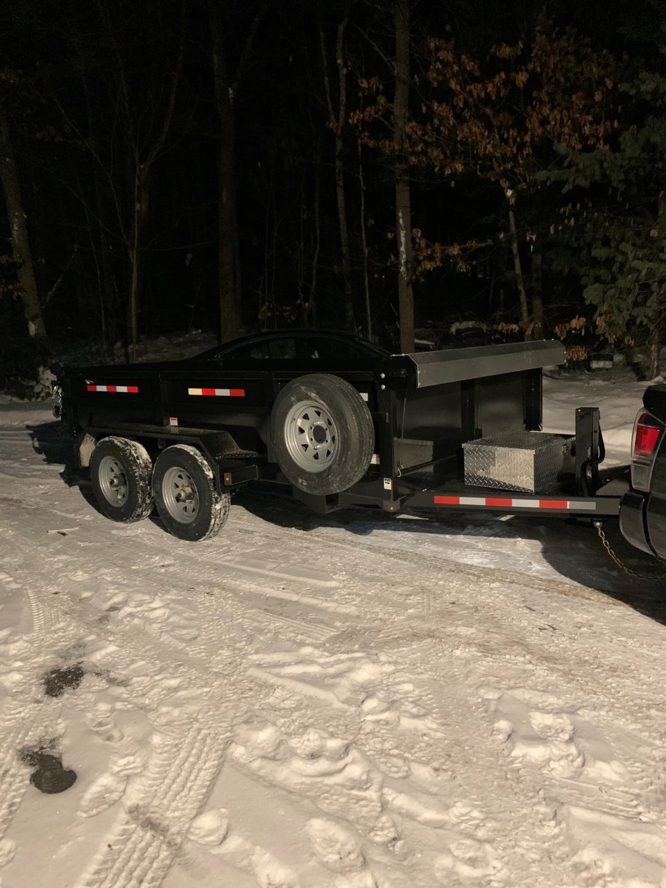

    That’s a beautiful trailer, way too big! I hope you can trade it back in for something more practical

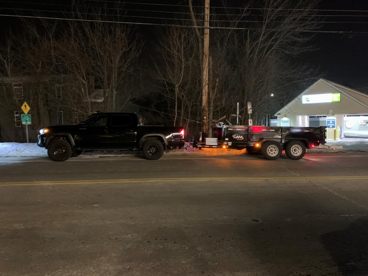

    Thank you. This being my first trailer I should have done more research, that's on me. With that said, I advised the trailer salesman this was my first endeavor and to help me with a choice on trailer (pointing at my Tacoma). Lack of knowledge on my part and a salesman looking to sell. Worst case I will just sell it and get something smaller. I love the Tacoma and don't want to damage it either. Thank you for the advice. Feeling a little stupid at the moment, but I have learned for sure.
    Thanks again everyone. I will keep you posted

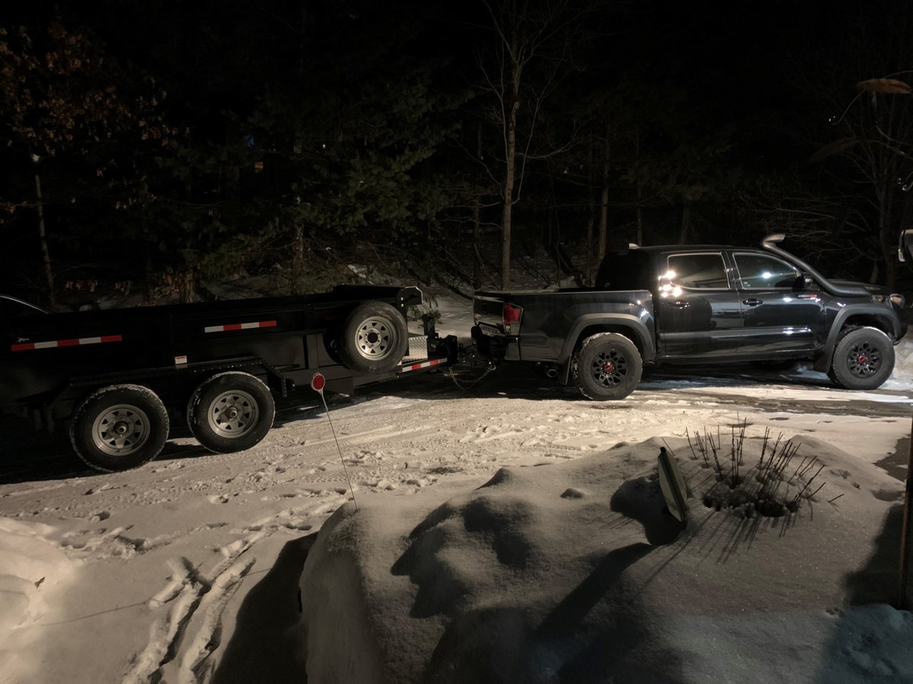

    I think you overdid it with the dump trailer. While it may fit your Kubota with the FEL on, I think your total GVW is above what will be comfortable (never mind legal). I went with a single axle trailer simply for trailer brake maintenance (2 wheels vs 4). You'll also be too tempted to fill the trailer with stuff and REALLY tax your Taco to safely haul it.

    You really need to take a look in your owner's manual regarding towing. You will see that the truck is designed primarily to haul, not to tow. There are a LOT of considerations you need to take when determining the safe, max tow rating. It it NOT just looking at the weight specs.
    For example, there are several calculations that have to be done (they are all explained in your owner's manual) AND equipment that must be added to reach the maximum tow capacity. You have a max tow rating, but it is dependent on meeting all the other "requirements". Your manual will tell you a weight distribution hitch is required, a brake controller is required. You will have a max tongue weight that can't be exceeded (easy to do when loading a trailer). You have a max Combined Gross Weight Rating (trailer, cargo, you, and the truck) that can't be exceeded, etc, etc..This is all in the owner's manual along with the arithmetic examples to figure it all out. All of this was in my 2019 manual and I'm sure yours is similar....
    Or, you can just skip the math and know that the little Taco isn't really up to towing a dump trailer full of dirt. My guess is if someone buys a dump trailer they are going to be using it more than a couple times a year, otherwise a "wanted" post in CL would get you a half dozen guys with F-250s to drop off the dirt for you, which is what I did when renovating my front lawn.

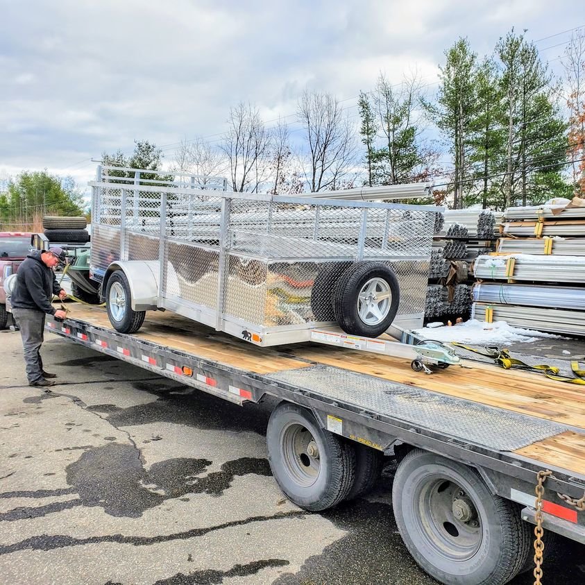

    Thank you HiPSI, I really appreciate the advice. I was thinking maybe an aluminum trailer as shown below. It appears Rugged Aluminum trailers will build custom, so maybe a 6.5 x12 foot double axel with short solid sides would work? At this point I'm planning on speaking to the trailer salesmen on my options for returning.
    Pictures 6.5 x 14 foot. two axels. Trailer is 1,184 lbs. with a payload of 5,816lbs
    Picture of solid side trailer.

    There ya go. That's all you need and all your truck can handle.
    Remember...you can pull a little trailer with a big truck but not a big trailer with a little truck.
    Pro tip for the trailer you have pictured... go spend a few bucks on a heavy canvas tarp. When hauling mulch, brush or pretty much anything small, lay the tarp down and then put the stuff on top. Once you get the load down so far, you can drag the tarp to remove the last of it.
    And you don't need solid sides. Just use the tarp you lay down first as sides. Once you load up, just use ratchet straps and you are good to go. You would be surprised how many times you don't really need sides.

    Missed the point...that trailer could hold way more than the Taco can pull. Too tempting.

    That trailer looks like it has two 5000lb axles. Fully loaded , it would be two much for the Taco. My trailers have two 3500lb axles which I think are more suited to the truck.

    If it's a 10,000lb capacity trailer then yes, I agree. If however if it's a 7000lb capacity then it's perfect.

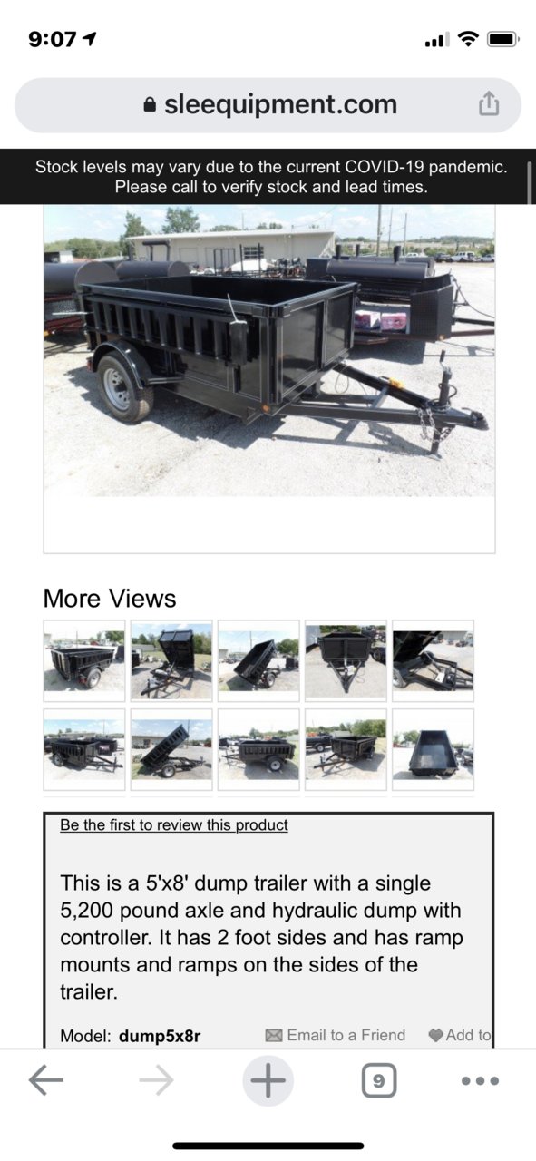

    Yes, it was a mistake purchasing the trailer. I will need to return it or sell it and get something like this shown below. I appreciate the help, just made a bad decision.
