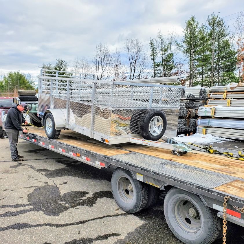

  15. Feb 15, 2021 at 8:32 AM
    #75
    NewHampshireNFA
    NewHampshireNFA [OP] Active Member
    Feb 13, 2021
    #356038
    44
    Tacoma TRD Pro 2019
    None
    Thank you HiPSI, I couldn't sleep last night worrying about this situation. This dump trailer was almost $10,000 and didn't match the truck well. I will send pictures of the trailer once I get it home.
    Lt. Dangle and hiPSI[QUOTED] like this.
