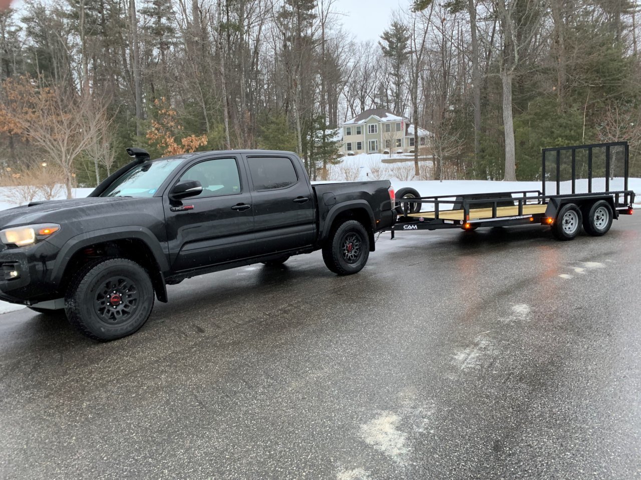

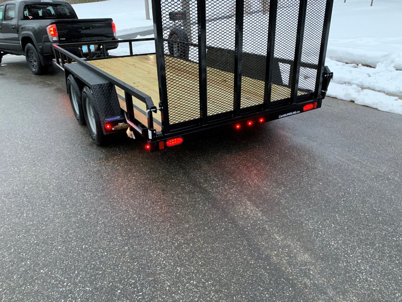

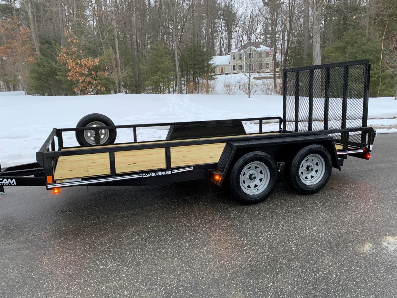

    Hello Everyone
    Here it is!! I really appreciate all the guidance provided by this forum. I look forward to learning more from all the forum contributors. Thanks again and stay safe

    Quick question for everyone. Would it be typical to add D rings to this style trailer? After looking at the trailer this morning, I don’t see any spots to secure chains for a tractor, etc. Maybe D rings welded to the outer metal frame?

    That's a plain in the ass, isn't it? I don't know why those hilljacks can't build them with! It's so handy to have 4-6 counter sunk D-rings in the floor so you can pull things down. I don't have on my latest trailer (just a lil guy) but the other two, I had to cut the deck and bolt to the metal underneath. Not a huge project,, but it seems like it'd much much easier to build with.

    Not needed. You can hook or wrap your straps anywhere on the side rails or lower edge of frame. When I haul my John Deere tractor, I wrap one end of the strap around the axel and the other end at the corner of the trailer. Four straps and you're done.
