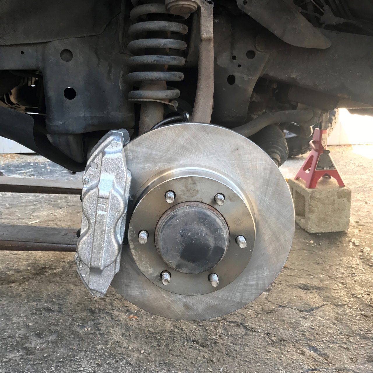

    In the process of updating my 2004 Tacoma's brakes with the 231mm Tundra package...Have acquired the following...
    Toyota OEM:
    04465-35290 Pad Kit
    04945-35120 Shim Kit
    43512-0C011 Rotors
    Aftermarket:
    Calipers - Napa Remfd 13WL (Eclipse Semi-Loaded)
    My question concerns the brake lines...Should I go with:
    LCE Performance's Tundra Brake Upgrade Kit - Brackets, Hard Lines & Soft Lines
    or
    Wheeler's Off-Road Stainless Brake Line Kit
    I had made the decision to go with the Wheeler's kit, but started second guessing myself as I read a number of threads concerning sealing problems (leaks at the banjo bolt)...I contacted LCE and asked about the fitment of their kit with the WL calipers as the description of said kit specifically calls out the 13WE calipers...LCE confirmed that the kit is indeed designed to interface with the WE and not WL calipers...However, this is contradicted by a number of posts were upgrades to the 13WL calipers used the LCE kit...My first question, will the LCE kit work with the WL calipers...Second question, is there any compelling reason to use one of the solutions (Wheeler's / LCE) over the other...Cost is not a factor, simply want the safest, most reliable set-up...Thanks

    The sealing surface on some calipers are not surfaced smooth were the line has to seal. The original line was a tapered flare seat. Not a banjo type fitting. If you went with LCE kit you'll have no problems

    Bottom of post #1 shows the difference in the caliper castings.

    Great discussion...Looks like I am going to go with the LCE setup...Seems the least problematic...Re the hard lines, I have read a number of posts were the OP used 2002 4Runner lines / spindle brackets (hard line to flex) with the WL calipers...

    I ran into an issue when I went with Wheelers lines and Napa WL calipers.
    The brake lines were designed to mate with a machined surface. BUT the WL calipers used a hardline with a flare on the end.
    I didn't notice it the first time around, but I would get a very slow leak at the mating area between the caliper and the copper washer.
    I ended up using a rasp file to smooth out the surface where the copper washer sat and haven't had any issues since.

    I think this is an issue primarily with non-OEM calipers, they have a rough surface for the banjo bolt to mate with. I installed used OEM calipers, and the surface around the brake port was fairly smooth. I didn't do anything to the calipers and used the Wheelers brake lines. No leaks. I made sure to use 2 copper washers on both sides of the banjo fitting.
