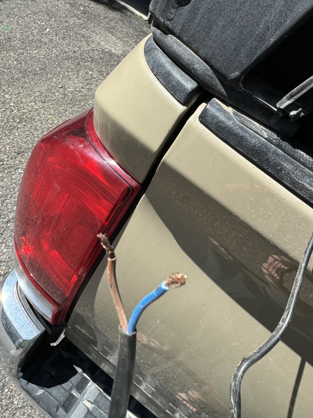

    Recently installed AluCab Canopy Contour on my 2018 Tacoma TRD OffRoad and wanting to confirm before buying, which harness(es?) I would need for wiring the 3rd brake light as well as the internal LED lights?
    There are brown/blue wire leads on both rear left and right sides near taillights.
    Thanks.

    A 2 wire lead implies power and ground. Test with a 9V battery or fused lead to your main battery to confirm. I sell a regular brake T as well as a flange mount option if you want a cleaner look when disconnected and are willing to drill. I also sell a long 2 wire (labeled as GFC) and 3 wire (superpacific) option if you want the help getting wire up and through the rail into the bed that way.
    I myself was a little hesitant to drill the bedside at first but I find the flange option to be awesome and the best choice even though I haven't ever taken my topper off. Just nice to have it there, secure, protected, and available to cap if needed.
