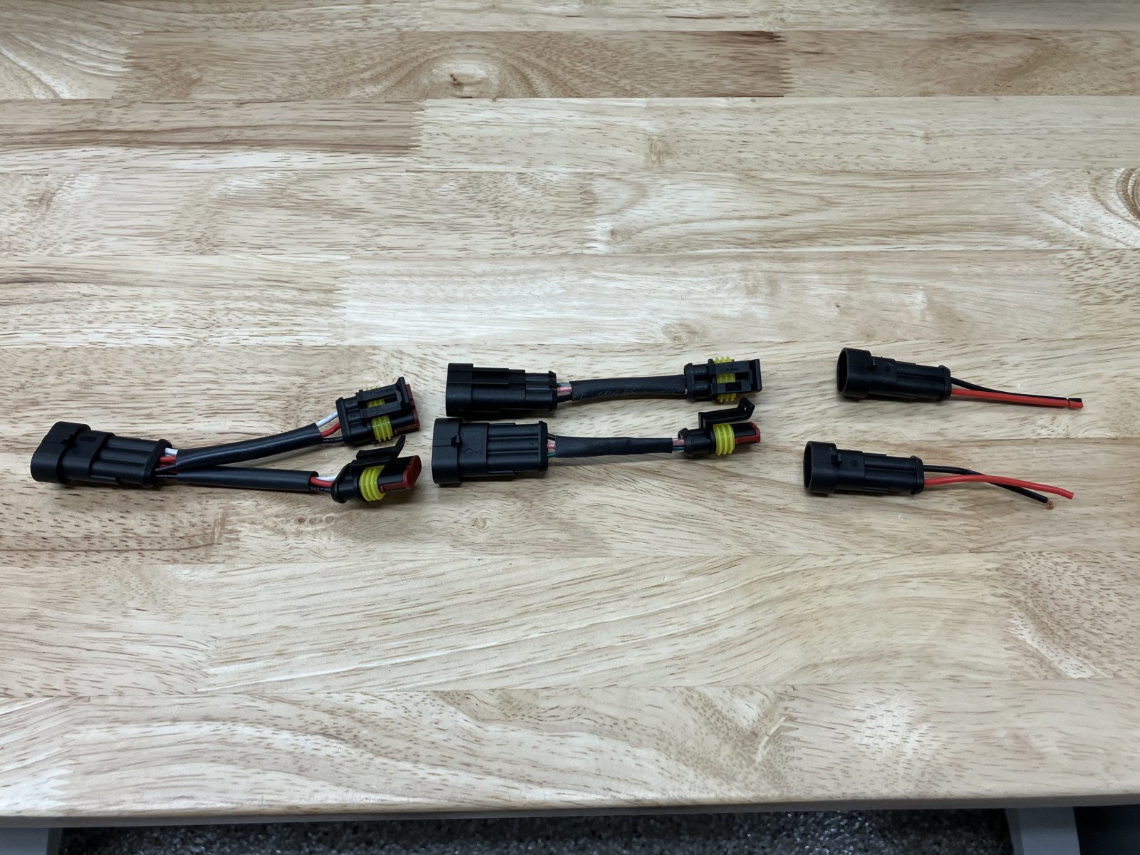

    If you need two or more outputs then I have splitters and an extra diode module per output. Given that the diodes are 1A so I prefer to only use them for single circuits.
    I don’t have an explicit sku for this but it’s included with the v5 and dd backlight skus.
    Photo is probably better than words.
