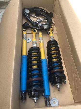

    I have a 2019 taco that im upgrading suspension will my factory suspension fit
    on my 2008 4 runner .

    Possibility the front will. The back. Nope. 4R is coil springs and the Tacoma is leaf springs

    so this would not fit on my 4 runner

    The fronts will fit and provide roughly ~2” lift. The rears will need the stock bushings pressed out and 4Runner size bushings pushed in.
    The 4Runner forums have more info on this just google “4Runner with Tacoma suspension”
    I think UCAs are also compatible. You just can’t take an OEM 4Runner UCA and put it on the Tacoma I believe.
