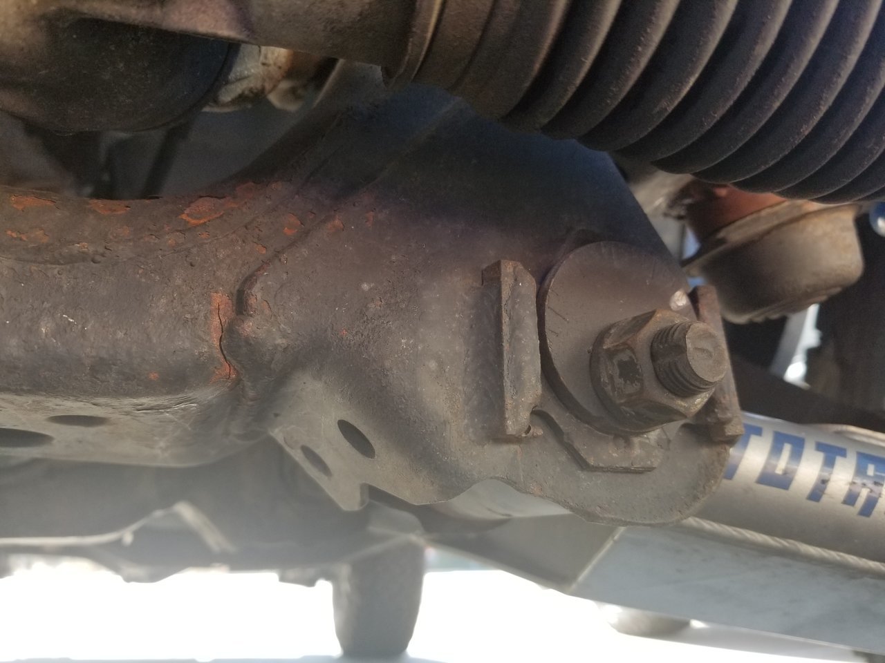

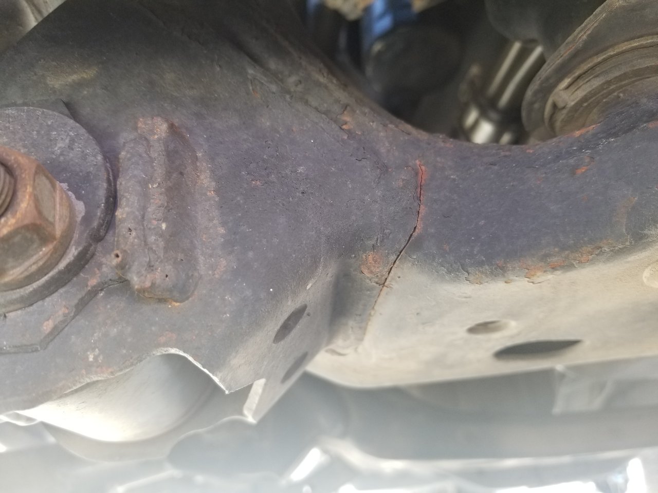

    tacoma 2007 lower weld cracked, oem frame welds. Any one have this too ?

    I have seen this before.....drill crack...weld...flap disk....1/8” plate overlay over it. I’d do it to all 4

    ya that what im thinking drill hole at each end of the cracks,then weld over it and put triangle gusset in then and plate over it.

    Do you have a welder??

    ya JTA or the truck shop
