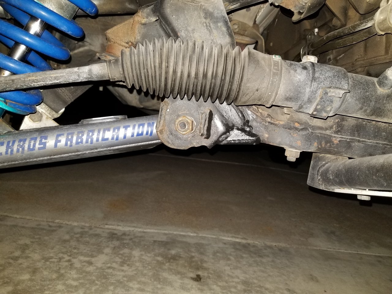

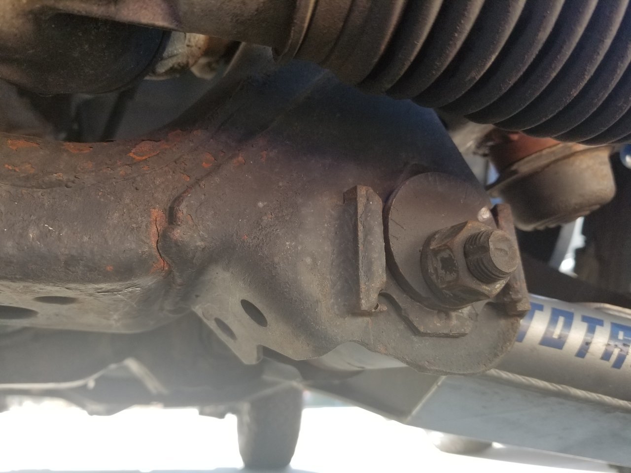

    TACOMA FRAME WELD CRACK OEM

    I would have someone gusset it for you. Since you are lt and probably do jump it (shiiittt I would too)

    No I was talking to ChadsPride because we both were posting in the same new threads
    I have seen 6 lug lt people gusset stuff for the very same issue you rant into

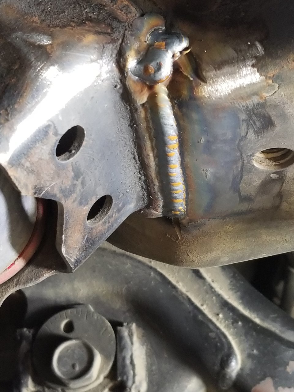

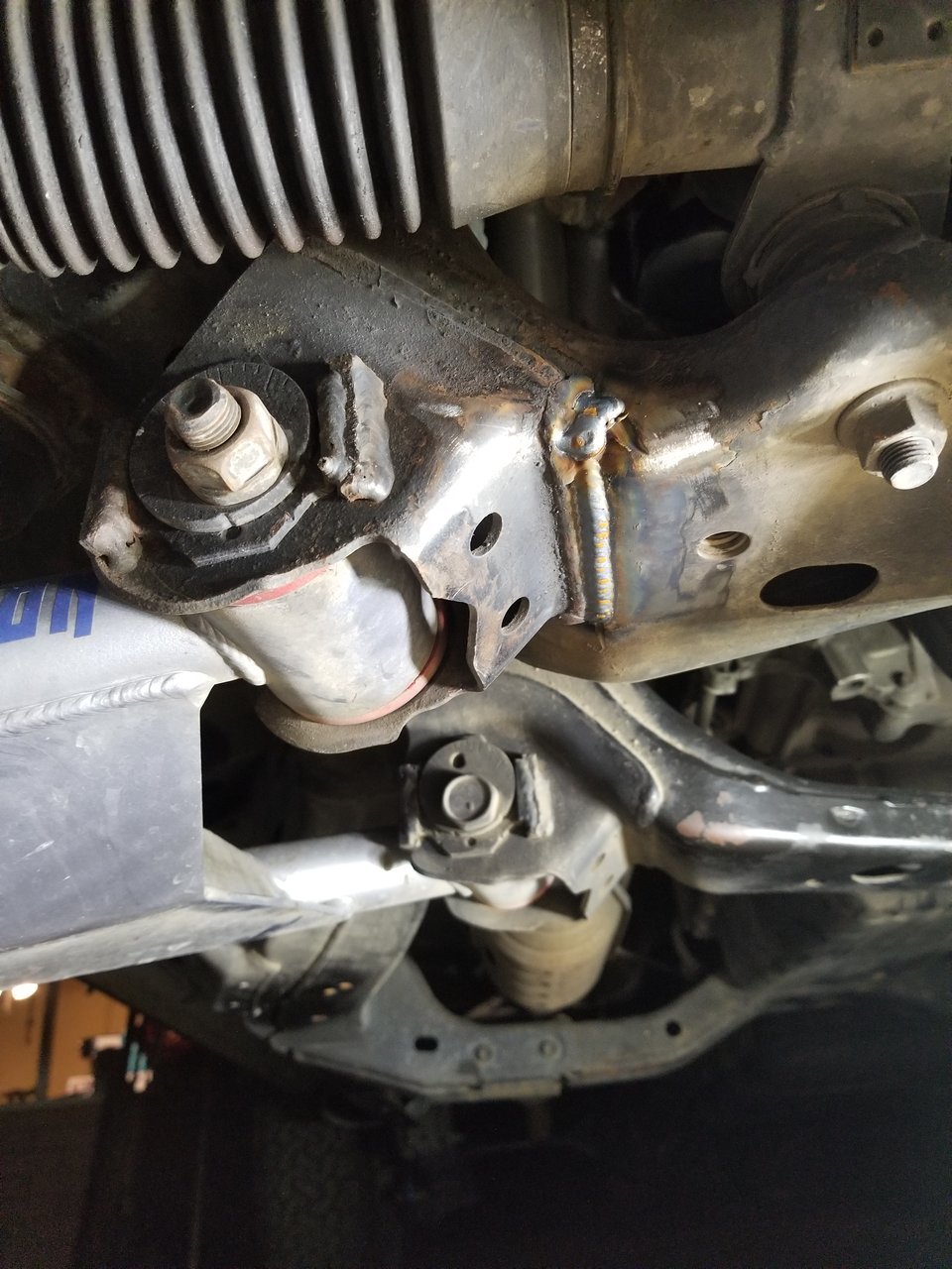

    Yep like that, just try to grind down a little of the factory weld to get better penetration.

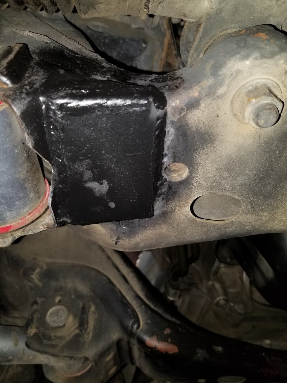

    Just saw the other pic, didn’t know it’s yours. Looks great, launch it and let’s see if it holds

    i hope so
