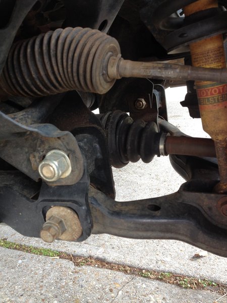

    This was the last one, I've also been told about a essentrics kit too

    Well I'd say you need an eccentric kit so your passenger side caster can be adjusted properly.
    I'd also request that your toe not be set to the upper level of "spec".
    A new eccentric will fix your caster, but judging by that particular printout I'm not sure why your tires are wearing faster on the inside.

    You said you recently put the 6" lift on, correct? Seeing that it is a drop bracket lift you would have had to remove the lower control arm bolts and cams to install the drop bracket. If they were seized you would have had to cut the bolts out -- the alignment paper also says "eccentric maxed out."
    The alignment spec are absolute trash. If the LCA cams are absolutely maxed out, then you need an aftermarket upper control arm with built in positive caster.
    I was barely able to get positive caster out of my setup with stock upper control arms so I put desert products UCA's on the truck. I now have 3.2 degrees of positive caster and the truck drives great.
    I would suggest aftermarket UCA's on any truck with 1.5" or more lift.

    it's possible but that wouldn't happen overnight, especially if he gets an alignment every month.
    he would have had to remove the bolt and cam to remove the control arm.
