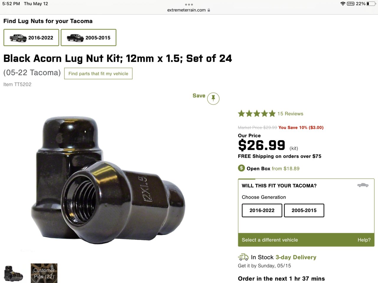

    after doing some digging and reading the posts on here about lug nuts and studs for aftermarket wheels, I looked at the nuts the guy at the custom auto parts store gave me, and they are just a normal conical shape. Would the .25 inches of the extended thread lugs be enough do you think? My other options are to either bite the bullet and get the studs replaced ($$$$) or return the wheels and restart my hunt for wheels that might be compatible with my studs as they stand now. Luckily my dealer said he’d make it right and take the wheels back if I go that route since he assured me in my noobish state that they’d fit perfectly.
    here are the nuts that I have now for reference.

    Conical or flat face lugs are determined by the lug matting surface on the wheel, not stud length

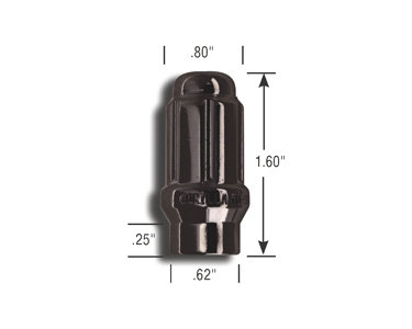

    They make a conical seat lug with an extended “snout” that would work.

    That’s what I was thinking - I’ve seen them with .25” of extra length down under the seat that helps fit inside the bore for the wheel - I just don’t know if that would be enough length

    something like this

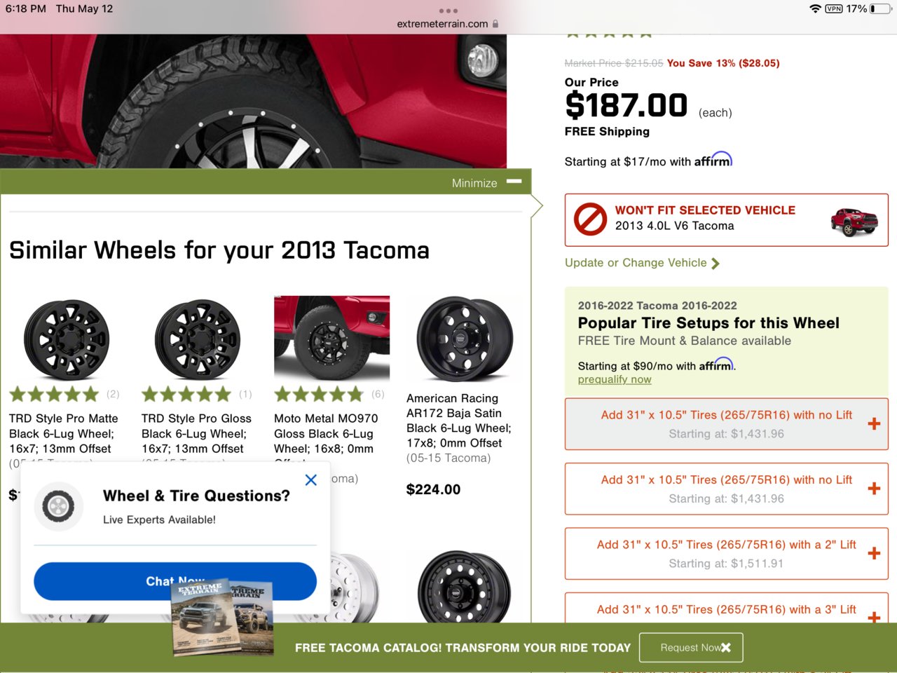

    These are the wheels I’m trying to run btw https://www.extremeterrain.com/moto...ined-wheel-16x8-0mm-offset-mo97068067300.html

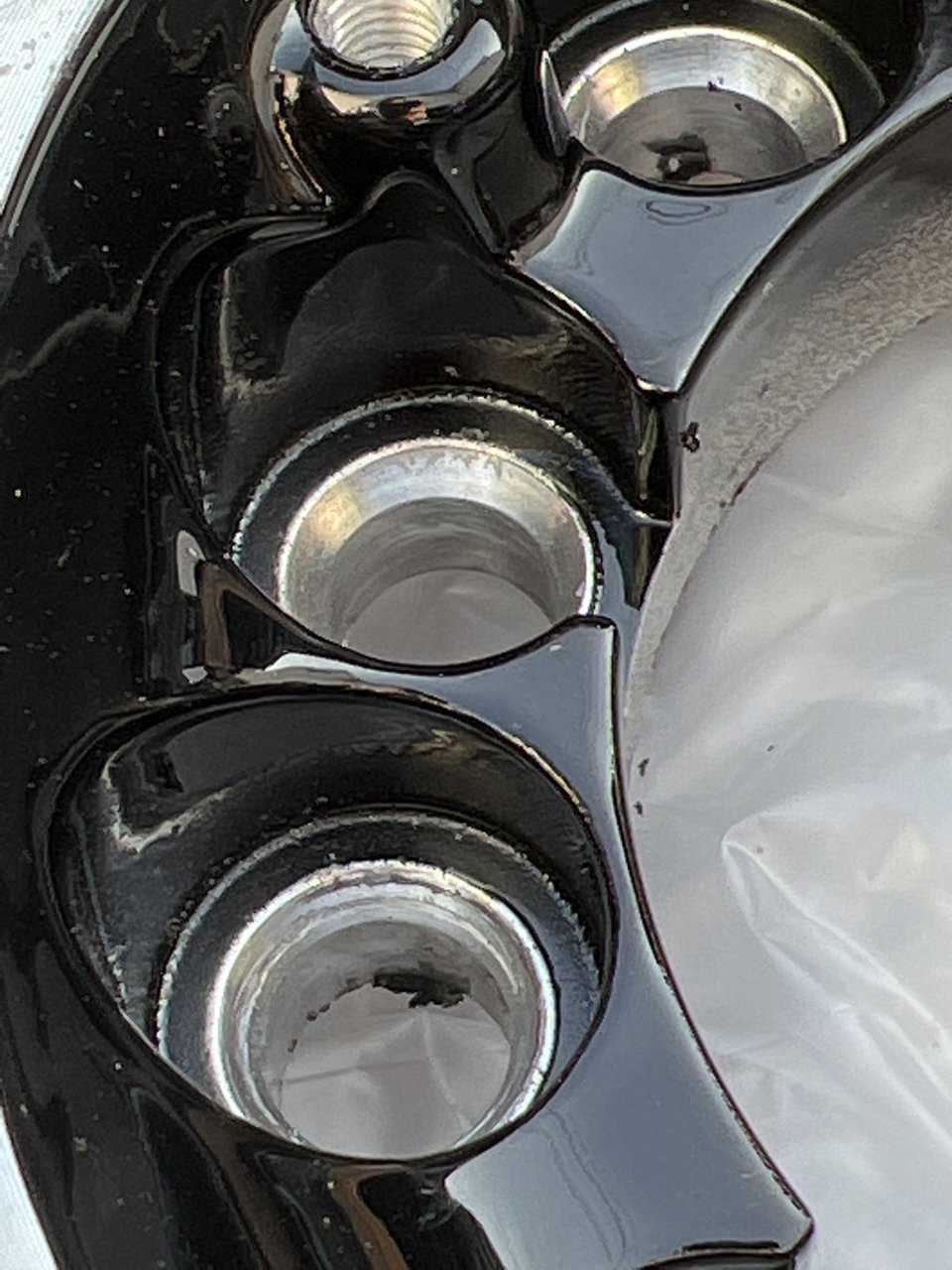

    Post a pic of your wheels that shows the stud holes well

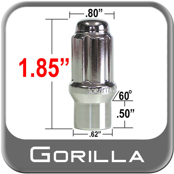

    Gorilla 21138ETXL
  13. May 12, 2022 at 3:16 PM
    Sharpish
    Sharpish Well-Known Member
    Jan 4, 2016
    #173981
    3,830
    Brian
    Victoria, British Columbia, Canada
    2012 Tacoma TRD OR 4x4
    Thats a half inch of extra threads. Do your wheels even use conical lugs?

    When I check it say will not fit, unless I a, doing it wrong. (which is usually what happens according to my wife :D)

    here ya go

    Haha! And which won’t fit, the wheel or the nut? I’m super new to this so I’ve just gone off of what the auto parts store owner told me and assumed he knew… but assume makes an ass out of u and me so ‍♂️

    I believe so, based on what I was given at the shop and it looks like the holes have a conical opening

    Yeah you need different lug nuts. Like you linked above w/ the .5” behind the seat. But measure first. Can’t have that extension be of equal or longer length than the wheel’s bore depth behind the taper.
