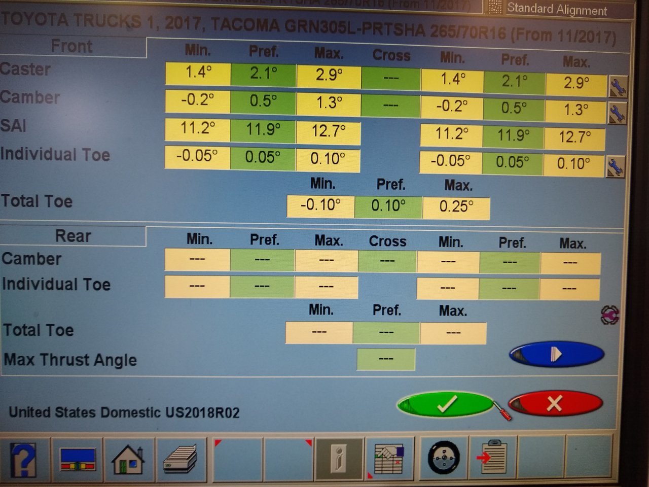

    FWIW here are the specs I have for your truck.

    Don't you need the build code for his truck?
    OP says he has a SR5; your screenshot shows something with 265s.
    I know they're all pretty close...

    His build code is in the pic in his first post and he said he had 265/70/16's.
    This is assuming his alignment guy put in the right code to begin with...But yes,they are all very close in specs.
