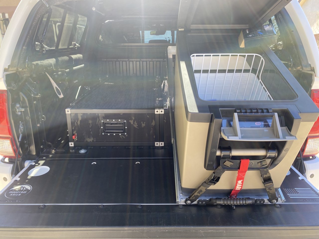

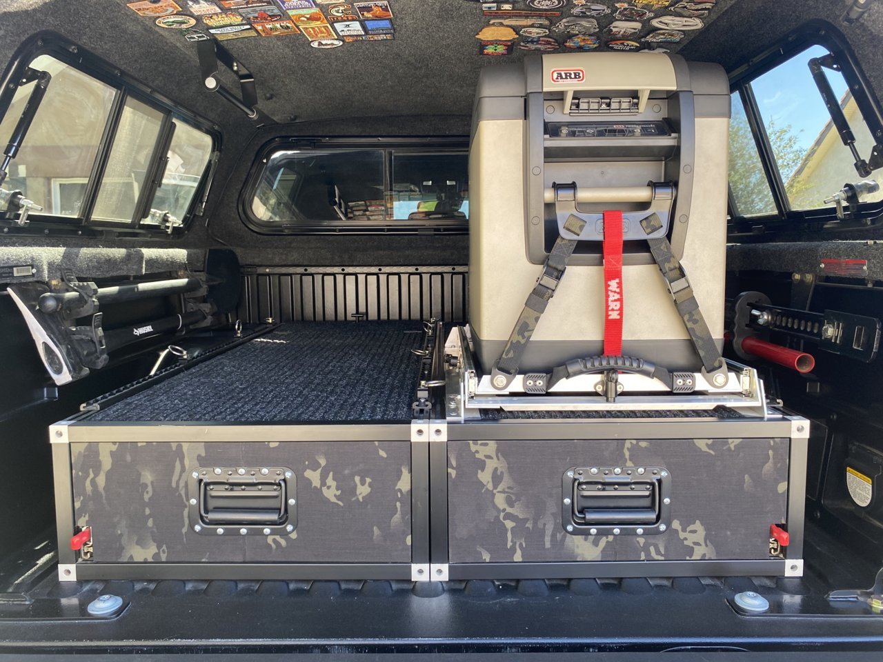

    Just a couple little updates for everyone. I’m a huge fan of multicam black. So I found some 3m backed multicam black panels, and also some multicam black webbing and finished my drawer setup. Now with the fridge slide, and also the arb classic series 50qt fridge set up in. My bed is now exactly how I imagined! Thanks for everyone who follows this thread!

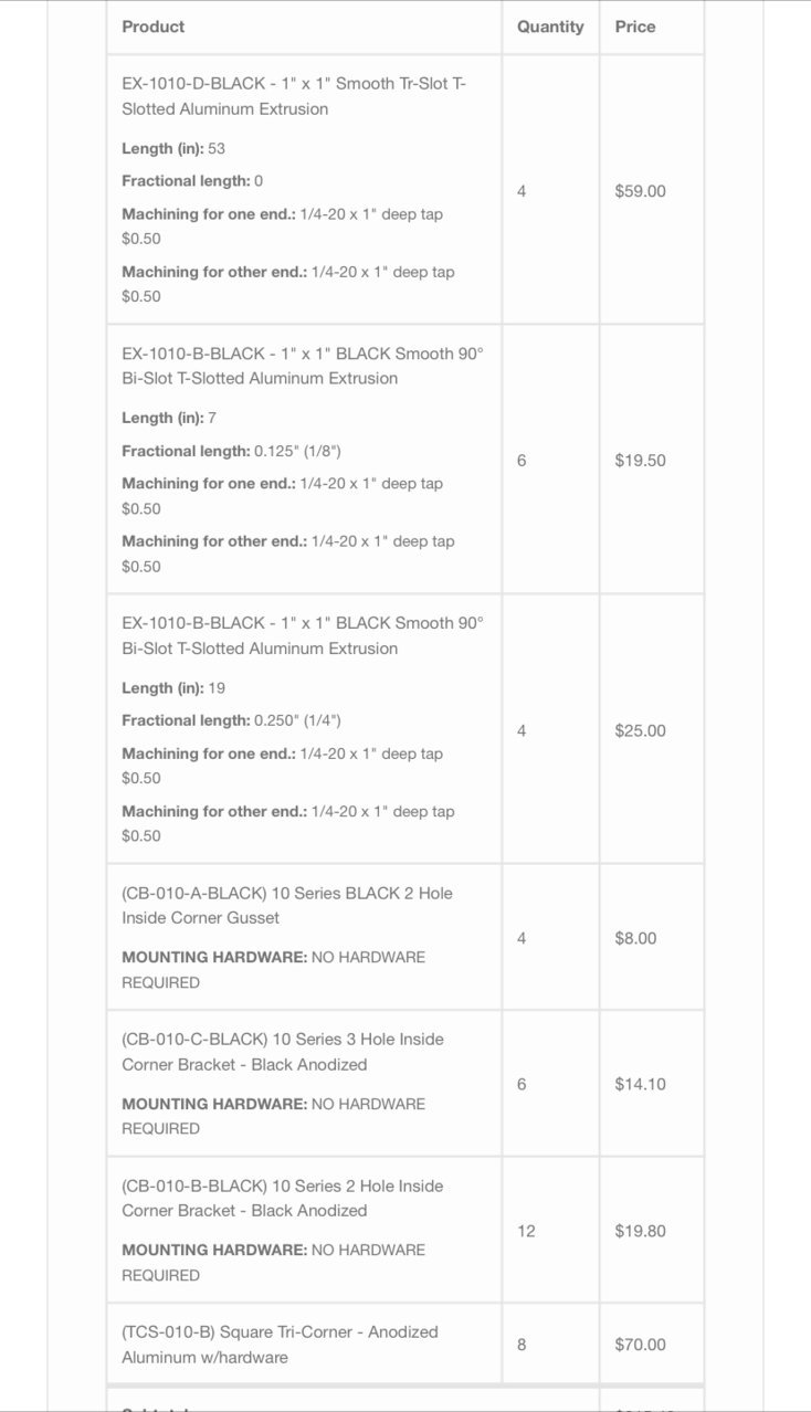

    Love it! Just stumbled in this. Building mine soon with 8020 bars. Do you have your order and measurements list in hand?
  10. Aug 10, 2022 at 2:15 PM
    #50
    mpatrick
    mpatrick [OP] Well-Known Member
    Aug 21, 2012
    #85259
    1,990
    Mason
    Rancho Cucamongbruh
    2019 TRD Offroad 4x4
    Bro Dozer II
    Sure do! Here you go.
    Area51Runner, Diesel156 and Malvolio like this.
