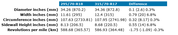

    So I’m running 295/70r17 which are 33.5” but I just call them 34s. Yours are 34.5” which is about the same height as 315/70r17, or what people commonly refer to as 35s.
    To run those, you’d have a bit of work to get them to not rub. Cut most of the cab mount back, hammer the pinch weld and firewall back a bit, and trim your fenders about 1.5” all the way around.
    Then there’s regearing your differentials, which is a couple thousand. That’s so there’s not a bunch of extra strain on your transmission.
