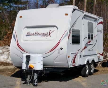

    Perhaps the above comments are not from actual towing experience with a Tacoma. We had a 2006 V6 double cab FWD and towed a tandem axle trailer from new. After 250,000 miles it still towed the trailer just fine. The drawback was a great reduction in mileage from 19 or so without the trailer to under 12 mpg when towing. It never felt as though it lacked for power though we didn't push it on long grades. Our trailer dry weight was 3425, loaded I'd guess a bit over 4,000 with a 300 lb hitch weight. We used an equalizing hitch. We now have a 2019 Tacoma, same style as our 2006 and towing is still easy, mileage towing still isn't any better. We've been happy even when the big Dodges and Fords go whizzing past us with their 40' toyhaulers.
