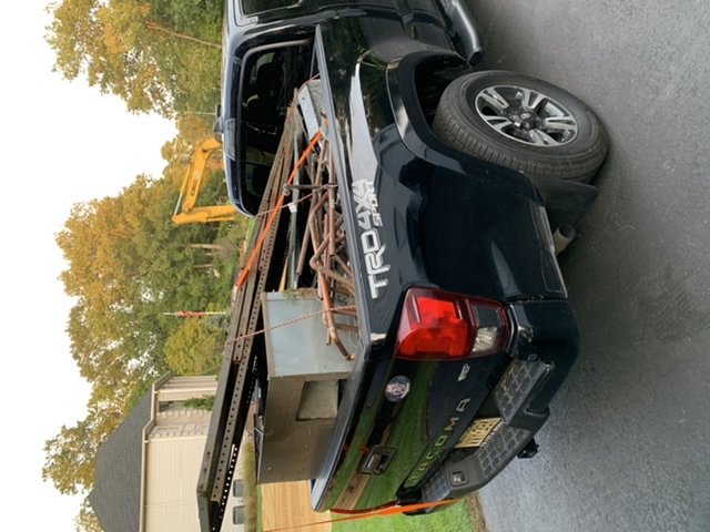

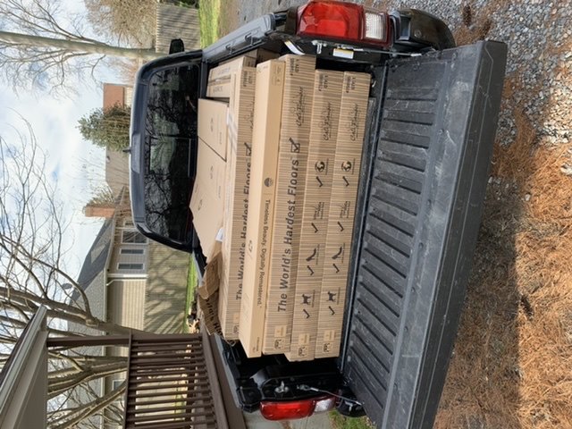

    Hi - I also work my Tacoma - 2019 TRD Sport DCLB V6 AT. Just a few days over a year old with 21,000 miles on it and that includes the 2 1/2 months it sat my driveway during Covid lockdown.
    The truck is currently stock. I have hold everything in it from lumber to scrap metal to 2500+ pounds of hardwood flooring. No issues at all with any of it.
    I think trying it out before making any major investments might be the smart money. Once you get a real feel for the truck and what you can handle you might then consider appropriate alterations/upgrades.
    Just one mans opinion ...
    2500+ lbs hardwood flooring
    Almost 600 lbs scrape metal

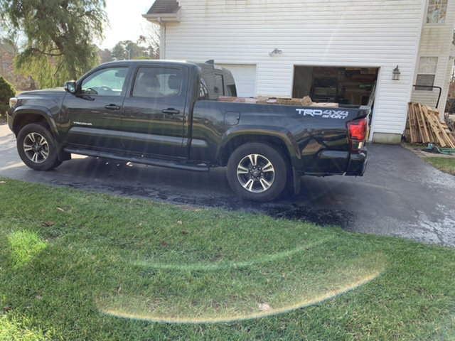

    I do:
    Here is the side view with load -
  9. Jan 1, 2021 at 5:32 AM
    #49
    woodsy
    woodsy Well-Known Member
    Dec 12, 2020
    #349445
    948
    Ohio
    2021 Tacoma TRD Sport Premium
    Cool. I thought it would be squatting worse than that. How did it drive with that load?

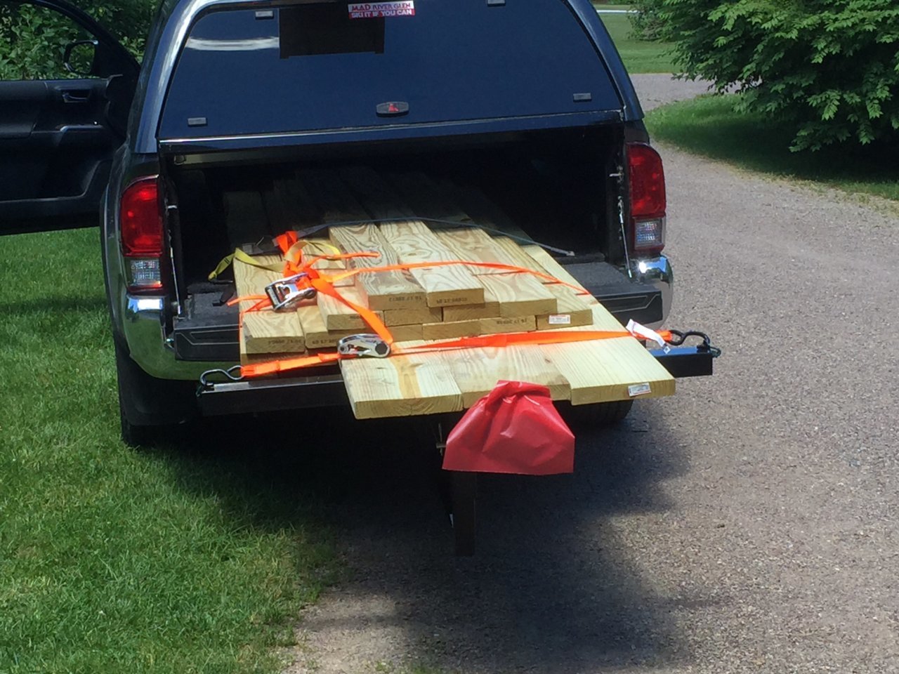

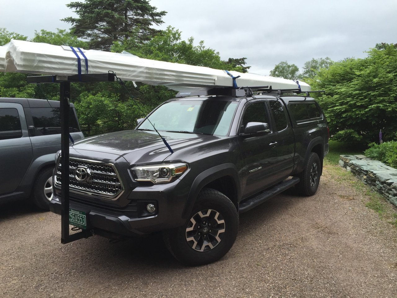

    This is why I went with Sumo springs instead of air bags. In a typical day I might drive my empty truck to the lumber yard, load it up and drive to the jobsite and then drive home in an empty truck.
    Bed extender can be useful for those extra long loads on top or in the bed.

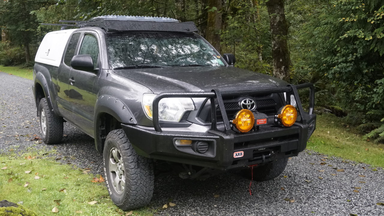

    2021 TRD SPORT AC MT
    So i now have my canopy and lumber rack on the truck, as well as a sleeping platform and drawer. the leafs are just about sitting on the overload spring. After doing some research I am thinking of just getting a new set of leafs. Did you have to lift the front end as well with Dakars? Truck looks good in the pic!
