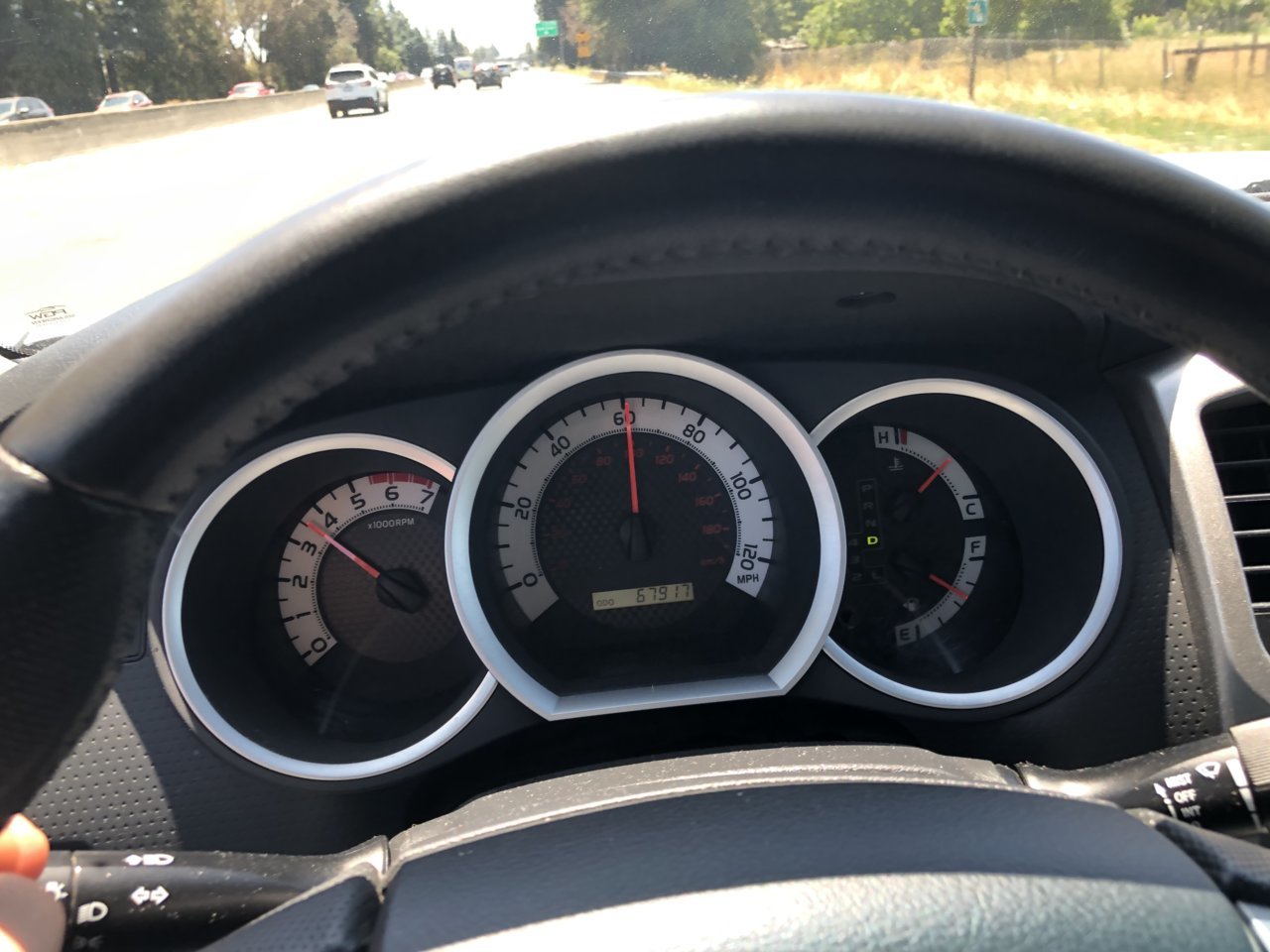

    (without counting for slip - read higher engine rpms - due to torque converter not locking up). with stock 3.73 gearing and stock tire size @ 75mph the following engine rpms will be seen
    3rd - 4300rpms
    4th - 3075rpms
    5th - 2200rpms

    Just got back from lunch definitely not 3rd I was at 3500 at 60mph. Maybe shifter cable is out of adjustment?

    Attached is the photo. I am in 4x2 drive. I had just moments before slowed down for traffic to about 40mph then accelerated back up. The truck drops down to third and never goes back up. I tried shifting from drive to 4 and back, no change. I tried shifting from drive to 4 to 3 and back up again and still no change. I pumped the breaks and turned off AC, no change. I exited the highway, stopped , then started and entered the highway again and the rpms were much lower at the same speed and I could not replicate the issue again.

    I drove it around with the toyota dealer. I showed him the pictures of the spedometer at 60, and the rpms high, and the other picture where the rpms are low/normal. We of course could not get the transmission to misbehave, except I did show him another issue where if you rapidly stop, then start up again the truck pauses then the transmission lurches forward suddenly. Anyway he recommends a transmission flush (he had another name for it but basically they fill it up and the old stuff comes out at the same time) because perhaps a bit of water vapor has been seeping in and making some erratic shifting. Anyway it just seems like the first think I would have to try in any case. I told him to check the electronics/software for any updates (whether via recall or simply recommended new versions). Will get the service monday and report back.
