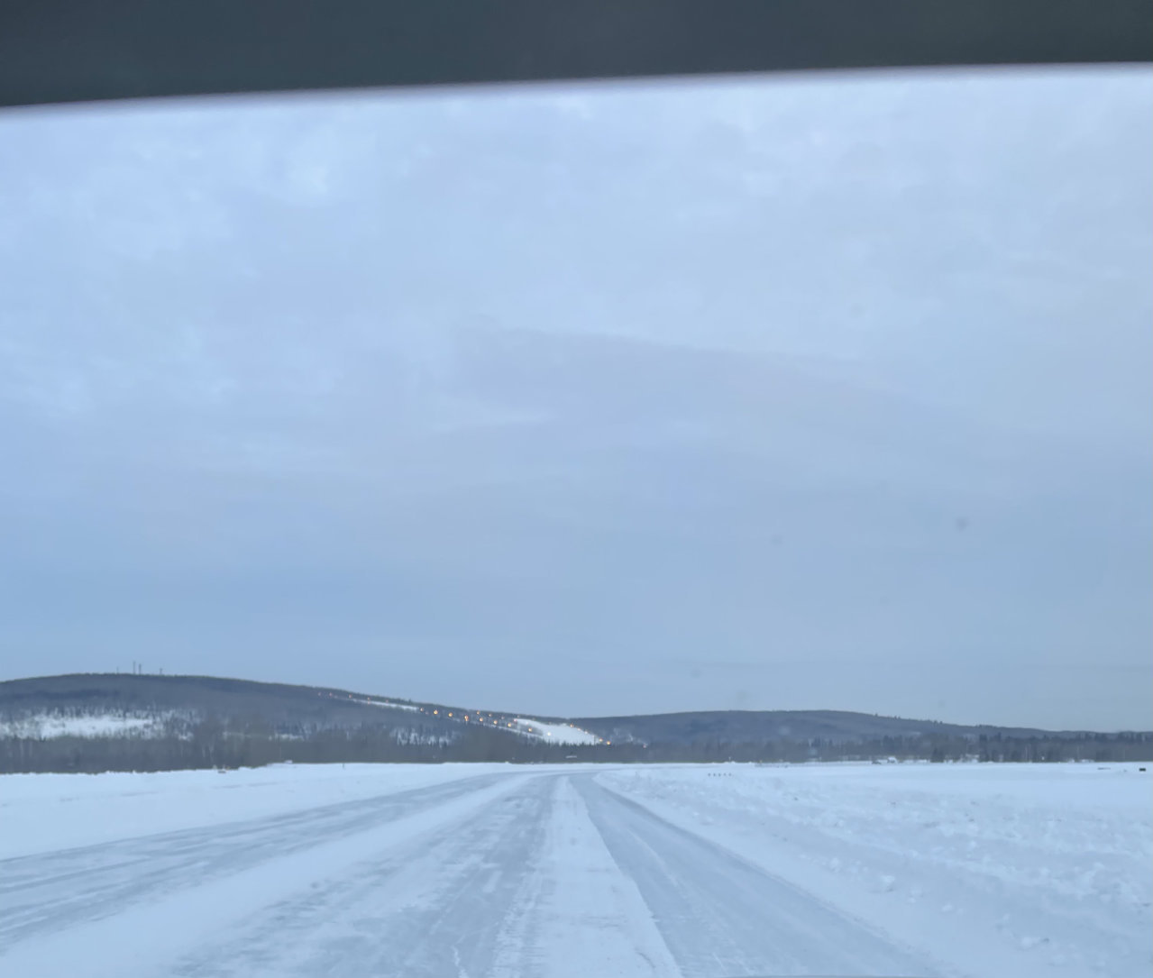

    Mine is empty and I don’t find it to be lacking in traction at all. The snow stays on our roads basically all winter, it gets too cold for salt. When the occasional plow or grader comes through, it basically has a zamboni effect and you end up driving on ice. Proper snow tires have the most impact, not just all terrains with the snowflake, actual dedicated snow tires. More expensive than sandbags, but if winter driving is a big concern, they are an invaluable investment.
    like somebody mentioned above, if you have 4wd, use that. My trucks basically stay in 4wd from late October through march.
    sand bags are always nice though. They’re cheap, can give you a little extra weight, and can be used for traction if you find yourself stuck on a hill/ice. Somebody was stuck in my driveway a couple months ago when they couldn’t get up the hill so I just threw down some sand and they were out.
