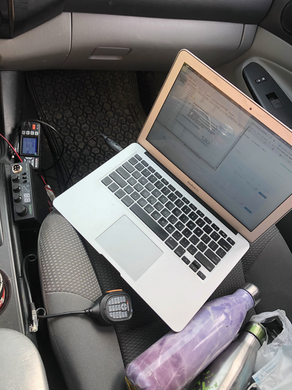

  17. Jul 7, 2021 at 4:50 PM
    #17
    snacsnoc
    snacsnoc Active Member
    Jan 2, 2021
    #351513
    25
    E
    2014 Tacoma 2.7L
    I mounted mine on the passenger side center console (see pic, taken of passenger seat). Antenna cable runs underneath the seat to a rubber plug. 12v cigarette lighter plug

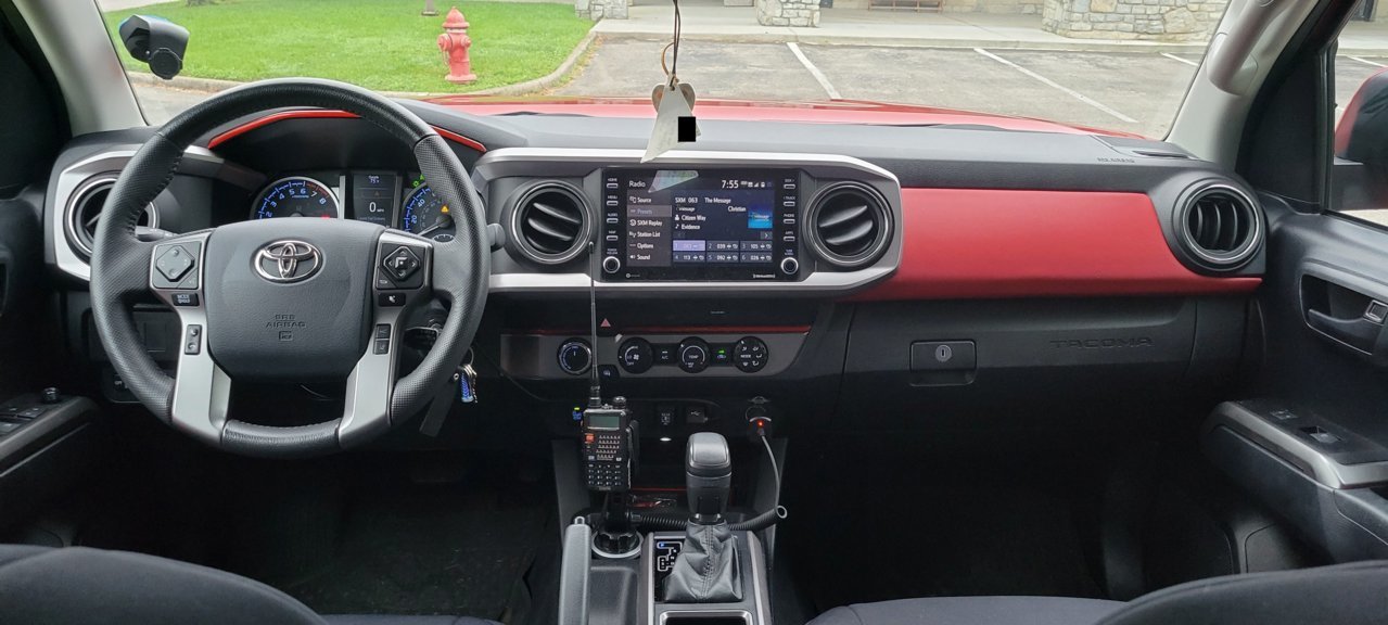

    Here is my current set up -
    Found a really neat little cup holder mount from Lido Radios - https://www.lidoradio.com/collectio...adjustable-heght-cup-holder-mount-for-all-hts
    and a Bao Feng Power Adapter on Amazon for permanent power. My only modification was to add a small strip of Velcro to the back of the battery and the base bad. The hole for the belt clip is a bit too wide and the radio would swivel when trying to use the keypad. Now it doesn't move.
    I will eventually add an external antenna, most likely with a hood mount on the passenger side or use the Rago bracket for the end of the bed. The point here is that the entire thing can be mounted or removed with no permanent modifications to the truck. And it's clean...
