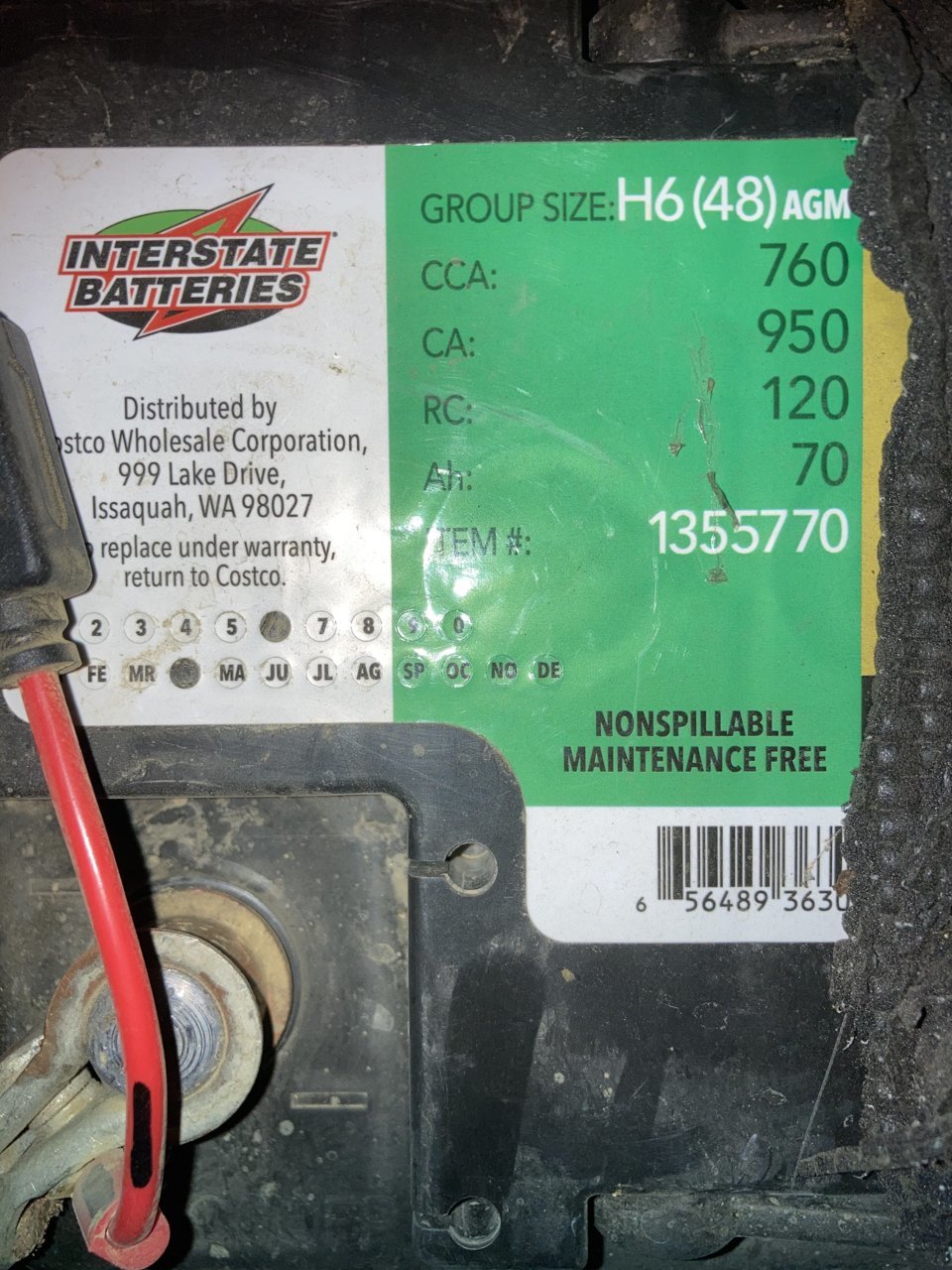

    C4Fab LoPro, BAMF Sliders, Ext ADS 2.5’s, 4.88's, OVTune (OG to KDMax)
  15. Jan 9, 2021 at 9:09 AM
    SRBenjamin
    SRBenjamin Well-Known Member
    Nov 14, 2019
    #310696
    1,077
    Benny
    Never heard of a $90. AGM 24f. Please enlighten me with a link.
    oconnor likes this.

  17. Jan 9, 2021 at 9:20 AM
    #17
    SRBenjamin
    Nov 14, 2019
    #310696
    1,077
    Benny
  18. Jan 9, 2021 at 9:26 AM
    #18
    SpeySquatch
    SpeySquatch Function over Form
    Mar 6, 2018
    #246516
    7,366
    2016 TRD OR DCSB
    bought mine for $96 at Costco
    no link, in-store
  19. Jan 9, 2021 at 9:28 AM
    #19
    SRBenjamin
    Nov 14, 2019
    #310696
    1,077
    Benny
    Still no help. as you cant get one for $96. today.
