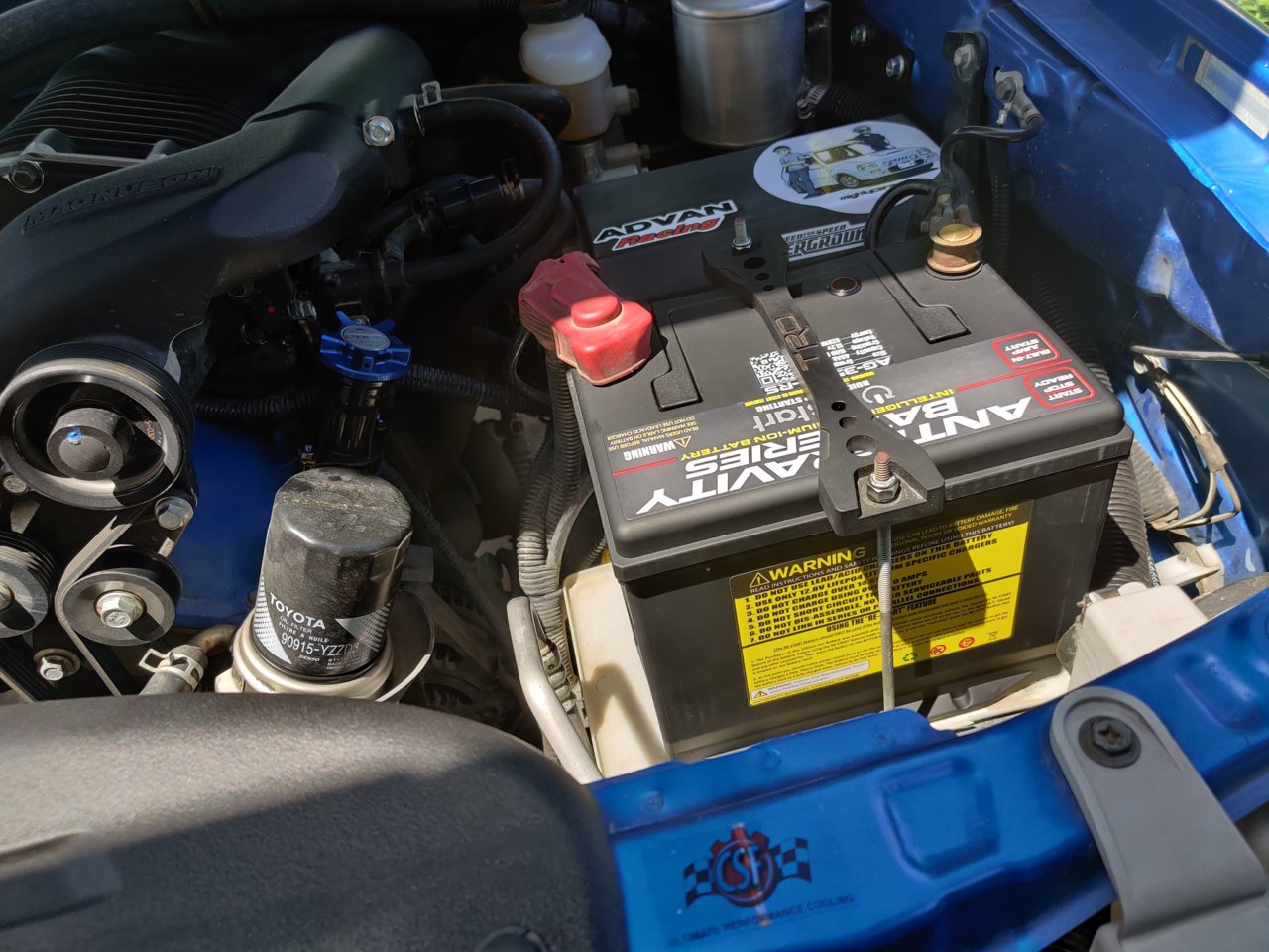

    not_nick
    not_nick Well-Known Member
    Sep 20, 2017
    #230574
    1,879
    keeping jersey dirty
    Antigravity is the way to go here, they even make standard group sizes that mount up to factory location. I don't want to leave any official review till i get a first winter and see how it does starts in negative temps and cold start after cold start and shit like that but it's been good so far. Great even.
    also in response to a few things i've seen mentioned: Many manufacturers are offering batteries like this as options and in rarer cases standard. Mostly luxury/performance brands but they're slowly making the rounds. Porsche is the biggest and starting to use them as standard on many of their vehicles and have as various options for a decade or so.
    Li-PO batteries (the ones that are susceptible to spontaneous fire) are becoming decreasingly common and should be avoided for an application like this. LiFePO4 batteries however (most of the ones you'll find in applicable sizes) are much more stable and will work fine for this. Be sure to do your research to make sure the battery you're buying also has a capable BMS (battery management system) in it and that should even further mitigate those risks and aid stable charging, prolonged battery life and performance, and stable outputs. That adds to the price but is not a big addition to the price anything lithium will cost at minimum
    Also the antigravity batteries have a 5 yr limited warranty, last i checked, that is quite fair. And should go an easy 10 yrs with care, regular driving, and without too much exposure to extreme climate. At that rate it's equivalent to spending 120-40 ish on a 1yr battery every year on its own. The benefits of getting the weight off the fender/driver side, reduced weight in general, and good starting and power supply of a lifepo battery make it well worth the cost up front if you have it, in my opinion.
    Edit just read first post: anecdotal but mine has been charging fine for months and i haven't noticed any negative effects yet

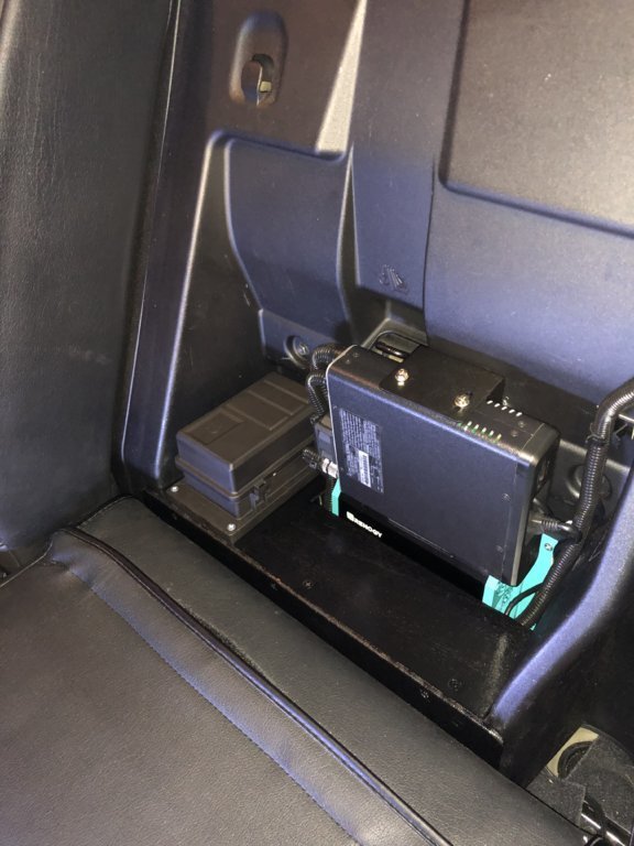

    I run my ham radio and always on ports from a behind the rear seat second battery.
    Chapter Six of my build thread has the writeup.
