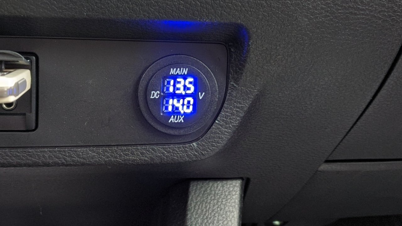

    I built and put a lifepo4 under the back seat. When truck is off, it's in parallel with the starting battery so the capacity of both is used. When truck is on, the lifepo4 is isolated and charged separately via a boost converter set to 14.4 volts. So the lifepo4 gets constant volts and constant current. I also integrated a temp sensor so if temp is below freezing, it uses the charging current to heat the battery first. Once above freezing, it starts charging.
    I figure it will last longer than the truck.
    You don't need a 500$ battery and a 200$ charge controller. Just $50 in parts for boost converter and relays, then build your own battery pack of any size.
    Under hood volts,. Back seat volts.
    wradar, JDSmith, not_nick and 6 others like this.

    That is cool. I like the dual volt meter. I have one for each branch, but the rear one is well hard to see unless I’m in he back seat. Typically when I’m in the backseat it is somewhat electrified so I forget to look at the meter.

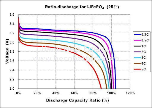

    LiFePO4 batteries are kinda weird on voltage. They dont have a linear voltage drop like lead acids do.
    On a lead acid (at rest, no active draw), you know that 13V is topped off, 11.5V is in the danger zone, and 12.3 is somewhere in between.
    From personal experience the topped off state (100%) of a Li-Iron is at 14.3 - 14.5 V, then they want to immediately drop to 13.5 or thereabouts and sit there for the vast majority of their discharge. Once you drop below 13.0-12.9 V you have maybe 10% battery left before it completely flats out at <11 volts. The huge horizontal line in their voltage curve makes it difficult to guess their state on just a voltmeter.
    Ud5FHEmFeoCKAvdUonvDFCSqXVPeqFKaDVvUl29t_f7075273e713d6f18ef4f3f86cee033306cb8fc7.jpg
    If you are putting a heavy cycle on lithium iron, I would recommend using a coulombmeter (amp-meter) to measure its state. Its slightly more accurate.

    Correct on all points and I have a similar amp meter already on other lifepo4 batteries I've built.
    One can sorta gauge the fullness of lifepo4 using those two volt numbers. Mine's set to charge at 14v, so bottom gauge will peak at 14v. Once near full, amps start to drop and the top volt number(vehicle volts) goes up, because of less load.. At which point lifepo4 is around 95% charged. If lifepo4 is 12v or less with no load, it's 95% dead. Most of lifepo4's energy is in the 3.0 to 3.5v range per cell.
