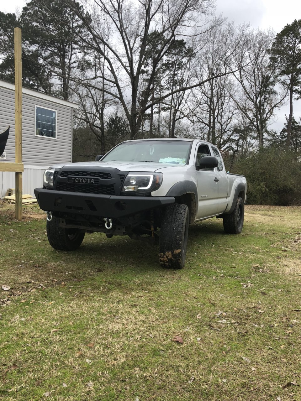

    B6EFA6FE-D57C-4861-83D7-465650E6488A.jpg I went with the black set. Output is just as good as stock imo.
    angeldavid216 and BassAckwards like this.

    Very nice. Where can i order a pair of black lights for a 2006 taco

    Where the hell did you get that grille and headlights... links please!

    Note they are only a cosmetic ‘upgrade’. OEM lights will outperform aftermarket ones, if you want a more aggressive looking OEM light I would recommend the smoked chrome TRD Sport/Pro lights.
    You can see the OEM smoked Pros along with best prices Ive found to buy based on year, and how to actually improve headlight performance here:
    https://www.tacomaworld.com/threads/the-ultimate-headlight-upgrade-h4-not-led-or-hid.398066/
