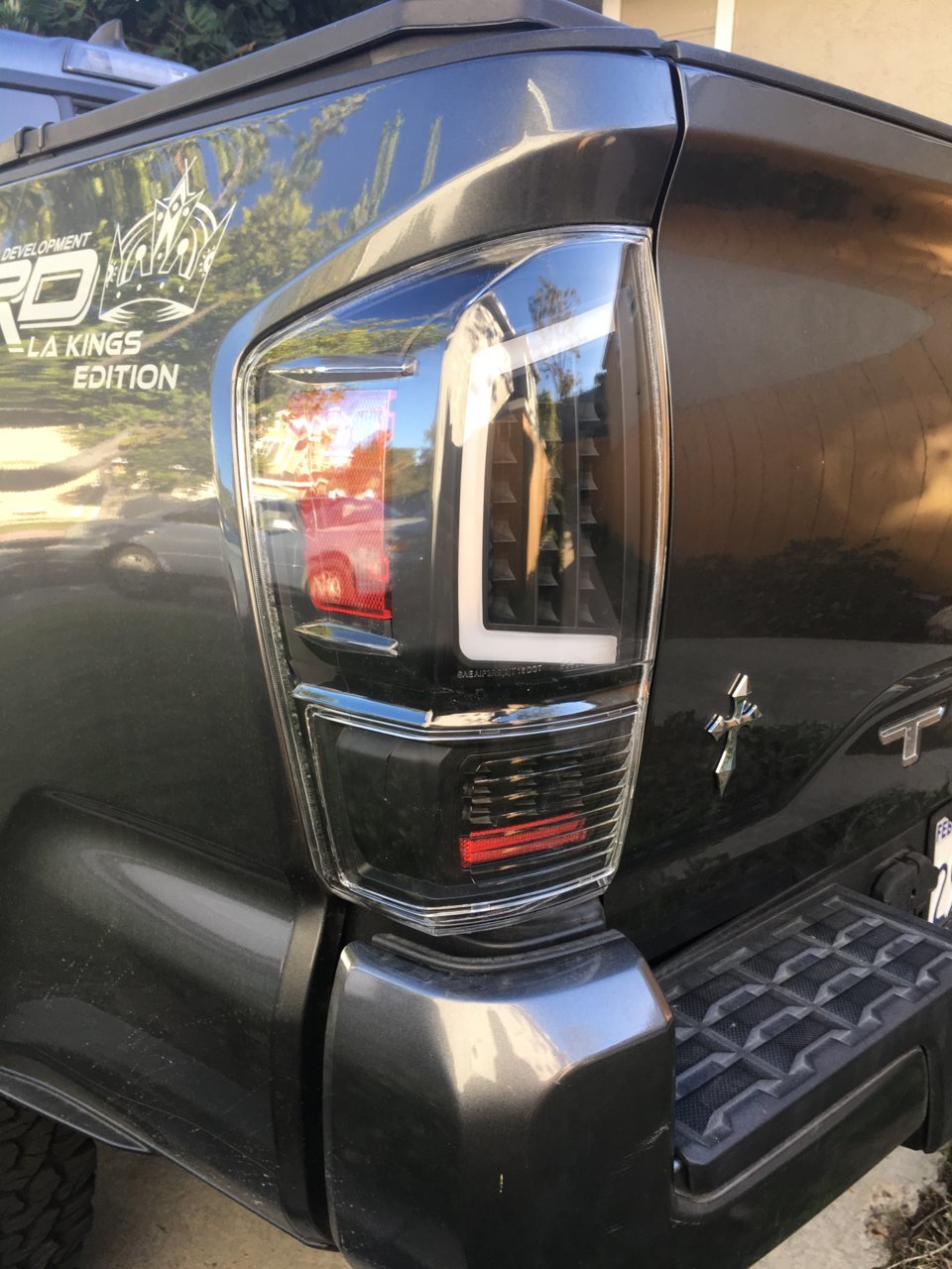

    Hey All,
    I have a question and was hoping someone could help me. I just recently installed those Tacoma Beast taillights and something interesting happened. You see I also previously installed this LED bar (with sequential lights) for my tailgate which I tapped into one of the taillights. After I installed the new ones from TB, every time I use the turn signal it blinks pretty fast (faster than normal and before). Also, the LED bar on the tailgate doesn't have the sequential motion anymore. Any suggestions or ideas how to fix this? Thanks in advance for any help!

    It’s called hyperflashing. There’s a few different fixes but I’m not familiar with them since I haven’t had the issue

    Grounds.

    Resistors

    Load Resistors should fix the issue.
