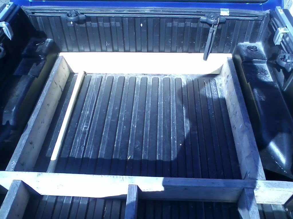

    Made this out of 2x6's. It is out of the picture, but I have a piece running across the back, which is tight against the tailgate when it's closed. It lifts out easily and keeps shit in place. I have plywood cut and hinged, which turns each box into a covered compartment as well so I can stash stuff and still use the bed for cargo.

    The bad thing about wood is it looks like shit rather quickly.

    Minwax polyurethane. or... who cares, it's in the bed, subjected to the weather.
