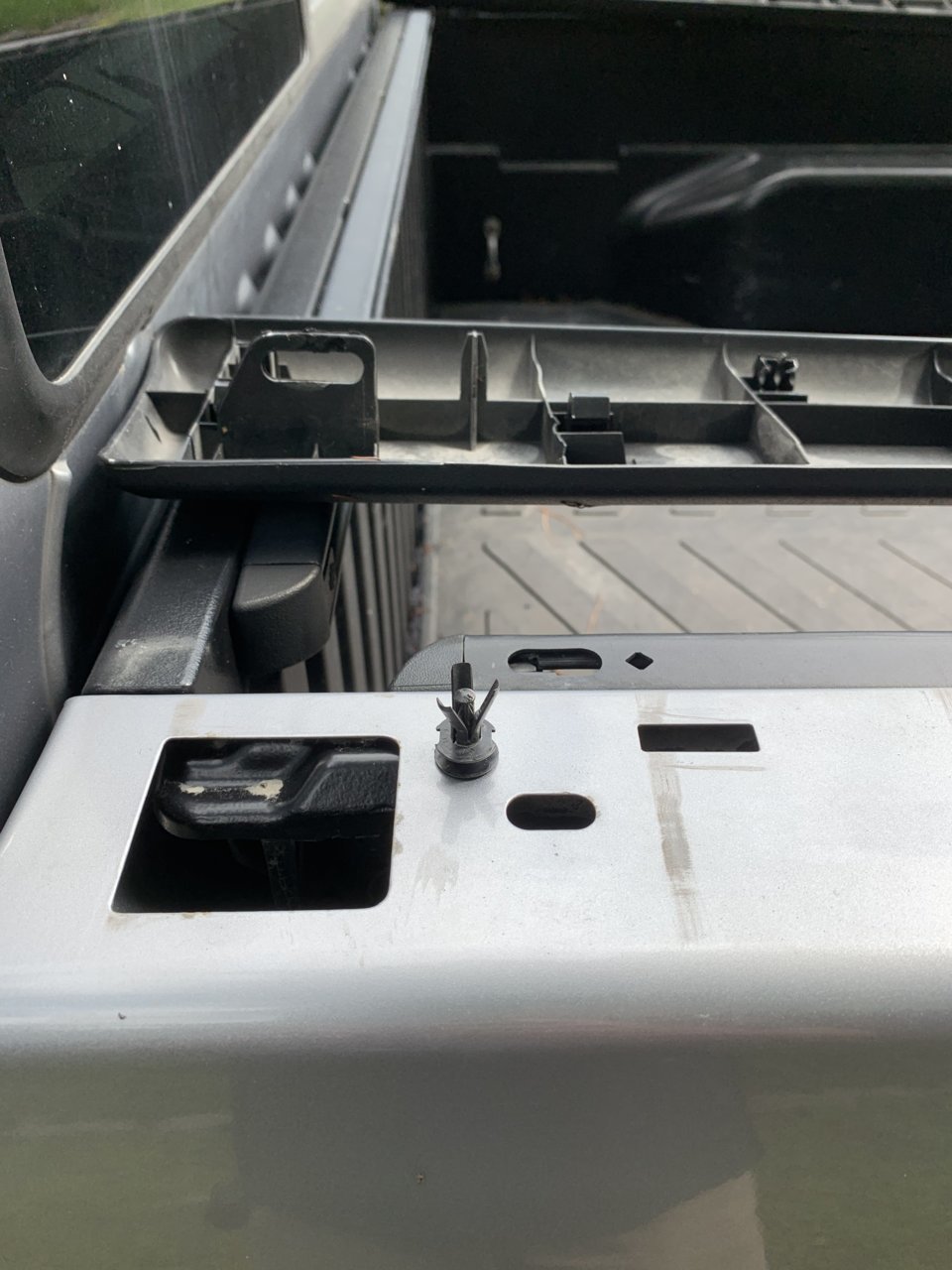

    There’s a few threads on this but I didn’t see pics. Figured I post ‘em up.
    I used a non marring pry tool to remove the two body clips on the ends. You won’t damage the loops if you pop these out first.
    The rest just pop right up.
    Also, the bed rail accessory rails are removed with a T30, not T10
