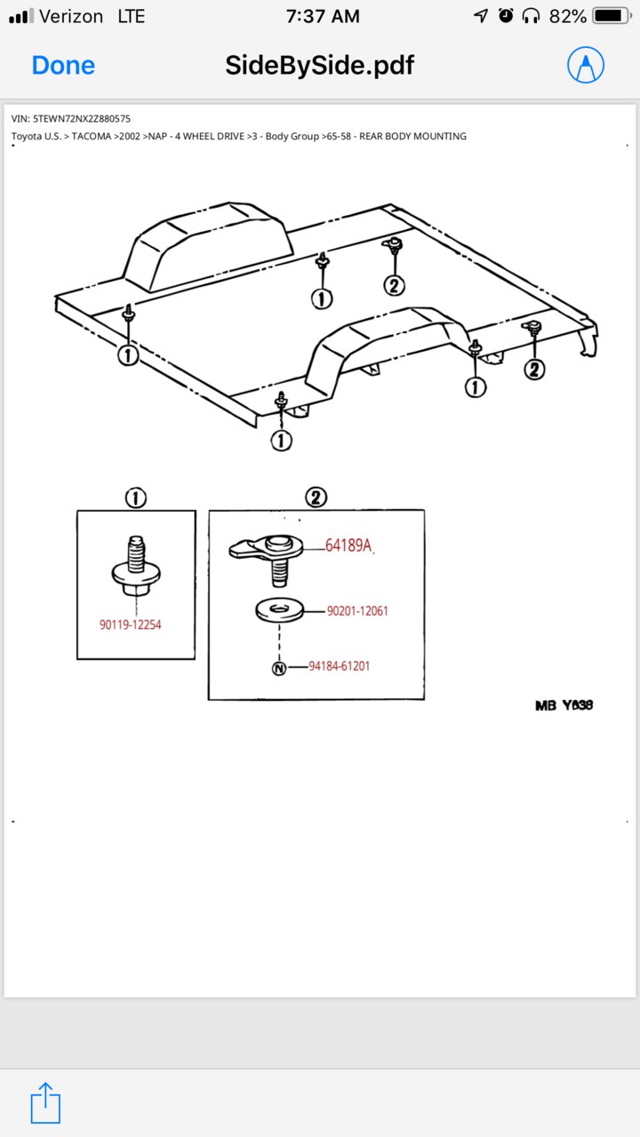

    Thanks everyone for the bed removal help, I started the removal and the four bolts toward the cab were fairly easy, but the two in the rear were nut and bolts which I had to cut with a grainder ,due to the notorious RUST. With that said I purchased all new hardware from Toyota to replace all nuts ,bolts and washers ... Thanks again everyone..

    Do you have by chance the part numbers for the bolts. I will probably need to put new ones in myself.
    Or any chance of finding them at a hardware store?

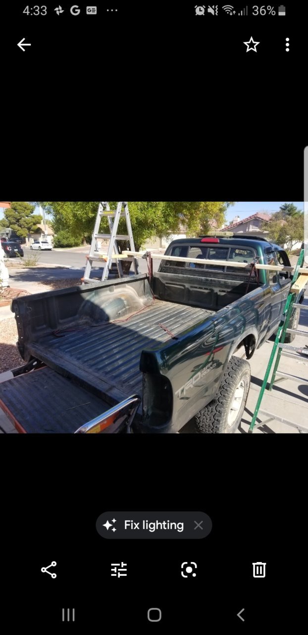

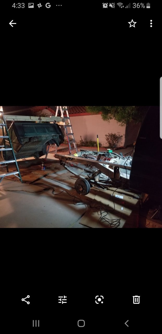

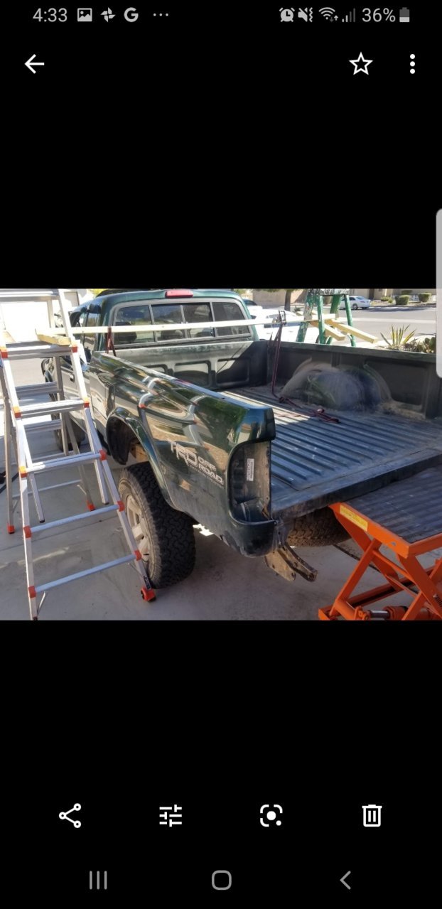

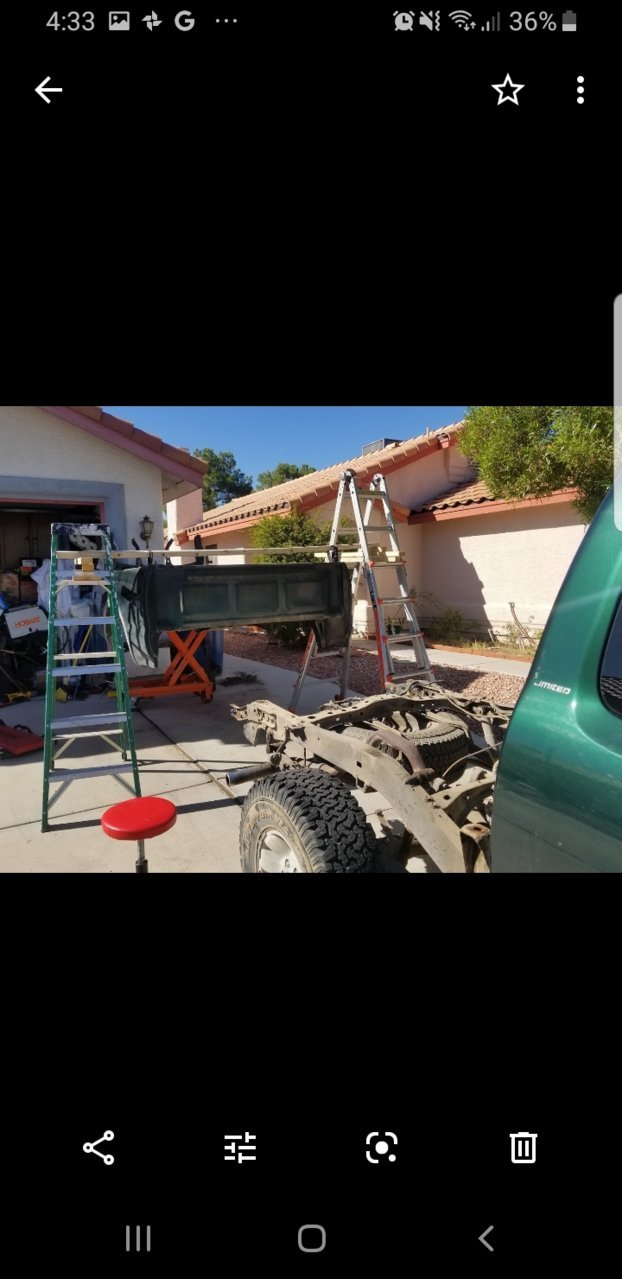

    Here is how I did it.
    I used ladders on the front side with a board across the.. then I used ratchet straps from the boards to the anchor footman loops in the bed to lift it.
    I had a table lift for the back but it was not heavy. Dont forget to disconnect the filler neck!
    I drove out from under it.
    I the placed cardboard down and flipped it upside down by myself to coat the underside.
