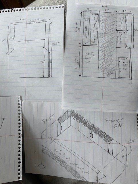

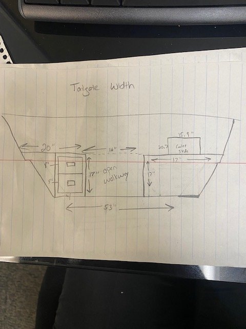

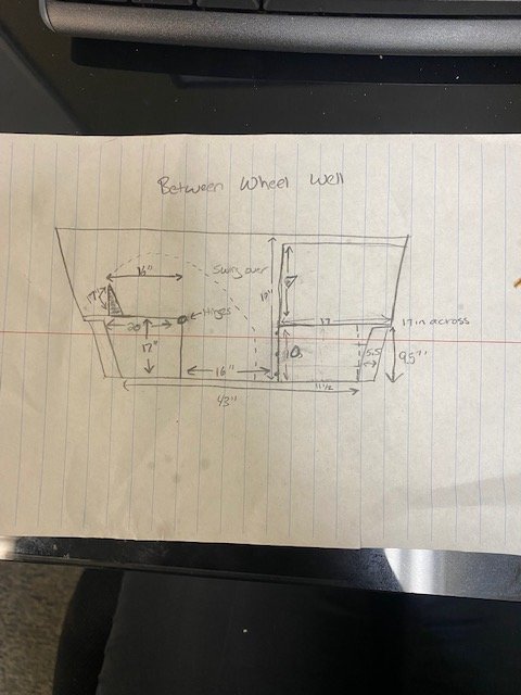

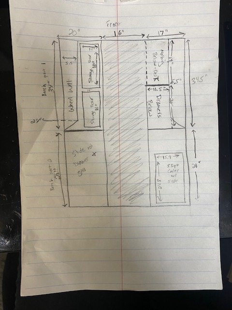

    I came across this thread a bit ago and have been going through my own build for my 2016 TRD pro double cab and wanted to throw it in here in case anyone is in need. Started with the ones from this thread and double checked/made some adjustments to account for the wheelwell going all the way forward to the cab. Hope it helps someone and thanks to this thread for getting me started!
