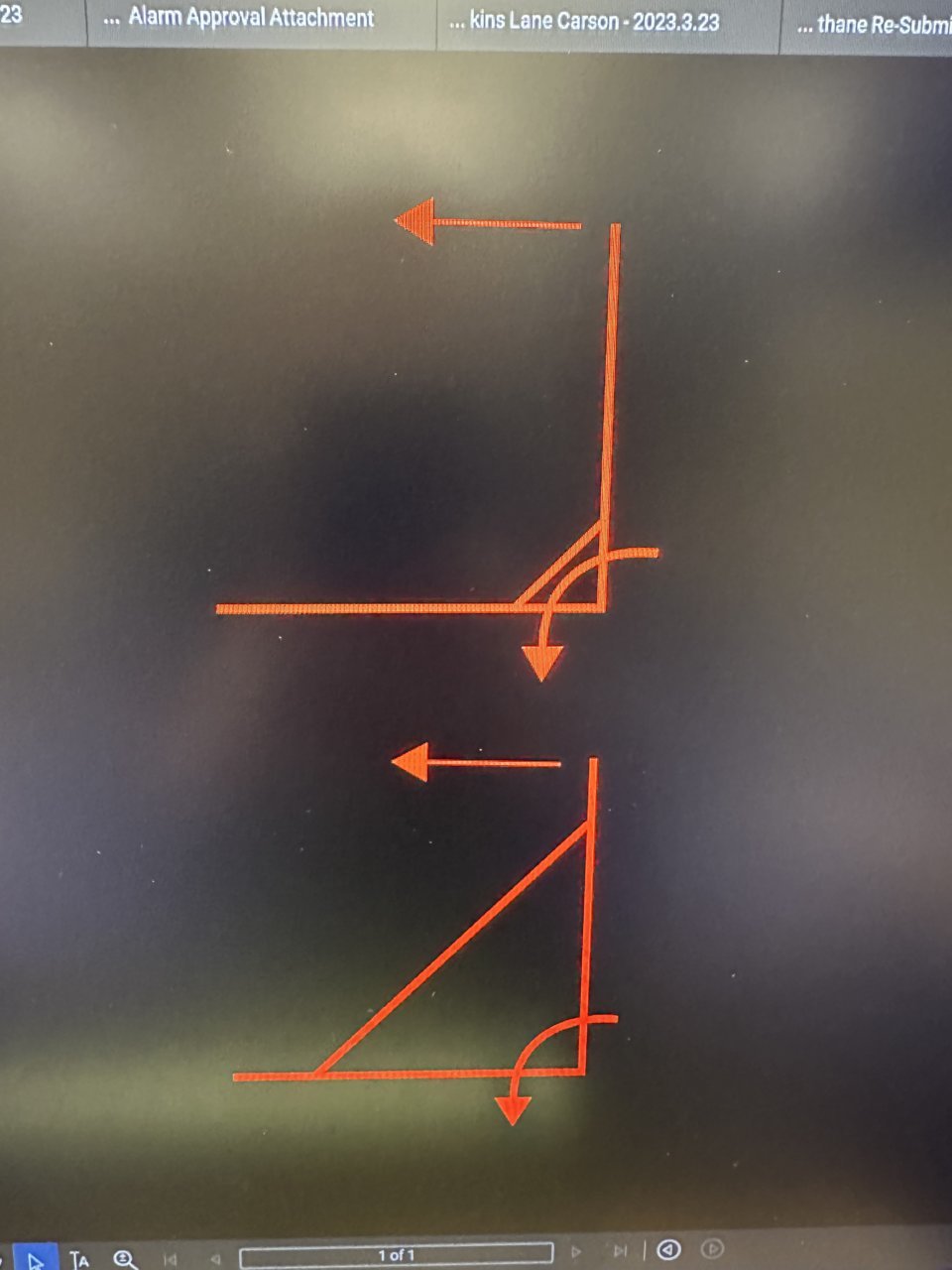

    I have a feeling that most people don't know what a gusset is or why it's important.

    I came to comment something similar. The TC design seems to have minimal reinforcement where needed to resist the bed-splitting moment.

    The welds won't crack... the whole thing will simply flex ---> because there is not much resistance to bending there...

    All things equal, except for the gusset, which will resist the moment more?54198511-8BB0-49D8-8381-52C7DA14466B.jpg If you want one that does not encumber the bed, 4WP is the solution. There is one other company that sells a low profile option like 4WP, but you have to get it with their tailgate skin.

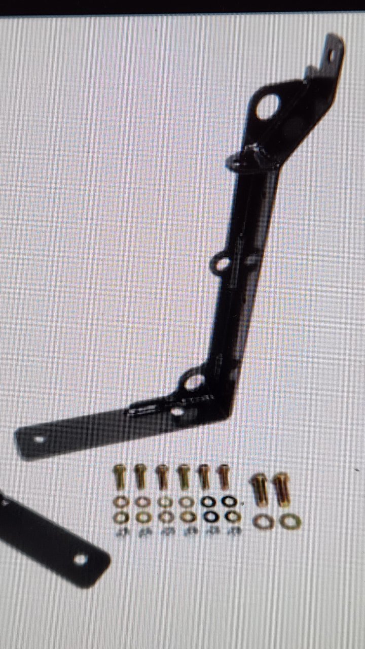

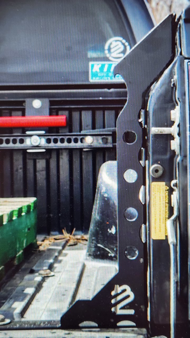

    No dig assumed...
    I started out doing engineering for structures - including design of floating cranes. I used to design welds on 4" plate structures on heavily loaded (moving) ships.
    . Even TC says their widget is for decoration.
    We don't need a heavy element there... but normally you want a stiffener to be stiff...
    Visually, the TC look 'wrong' even for aesthetics. They don't look stiff and they'll flex. (They use material that is too thin)
    That bit of additional material in the cross section and gussett size will do wonders in the right places.
    - Still, my primary goal was more tie downs. I drilled 2 more same size holes in the top part and they look / work much better for all purposes.
    AND they were a good amount cheaper...

    Please don't take offense to what I'm about to say, but the thing you call a perpendicular reinforcement has a name. It's called a gusset. And to be perfectly frank, if you don't know that word then you really aren't in a position to talk about the efficacy of a design, or the quality of criticism levied against it.
    Metals flex, especially at joints. Gussets are an easy way to help limit that flex. Since most fab shops use one of like 3 different steel alloys that all have somewhat similar material properties and most of these bed stiffeners are of the same basic design, you can pretty much fully judge a bed stiffener by the size of its gusset.

    to be clear, i own the tc's, so this isn't an 'i bought 'x', i'm gonna bash 'y'. i'm not ashamed about discussing it, my goal was specifically additional tiedown points, and the tc's fit that bill without obstructing the bed usage as much as other potentially better reinforced versions.
    the 4wp version came out about 6 months after i got my tc's. i hadn't installed the tc's at that point, and did seriously consider the 4wp version, as the perpendicular steel angle would naturally resist more force than the tc's design. j i choose to keep the tc's specifically because they've got more usable anchor points IMO than the 4wp version. if i had chosen the 4wp, i would've added a triangular gusset on the corner of the angle as well to further ensure less issues.
    really, any amount of metal around a corner adds strength to the corner. so while i would never vote the tc's to be the strongest, and the real reason i started digging into the blind pandering of "they're patented, they've got to be da best!", they're going to be better than no bed stiffener at all. but i'd still argue that 60-80% of tacoma's (mine included) don't actually need any type of bed stiffener anyways.
